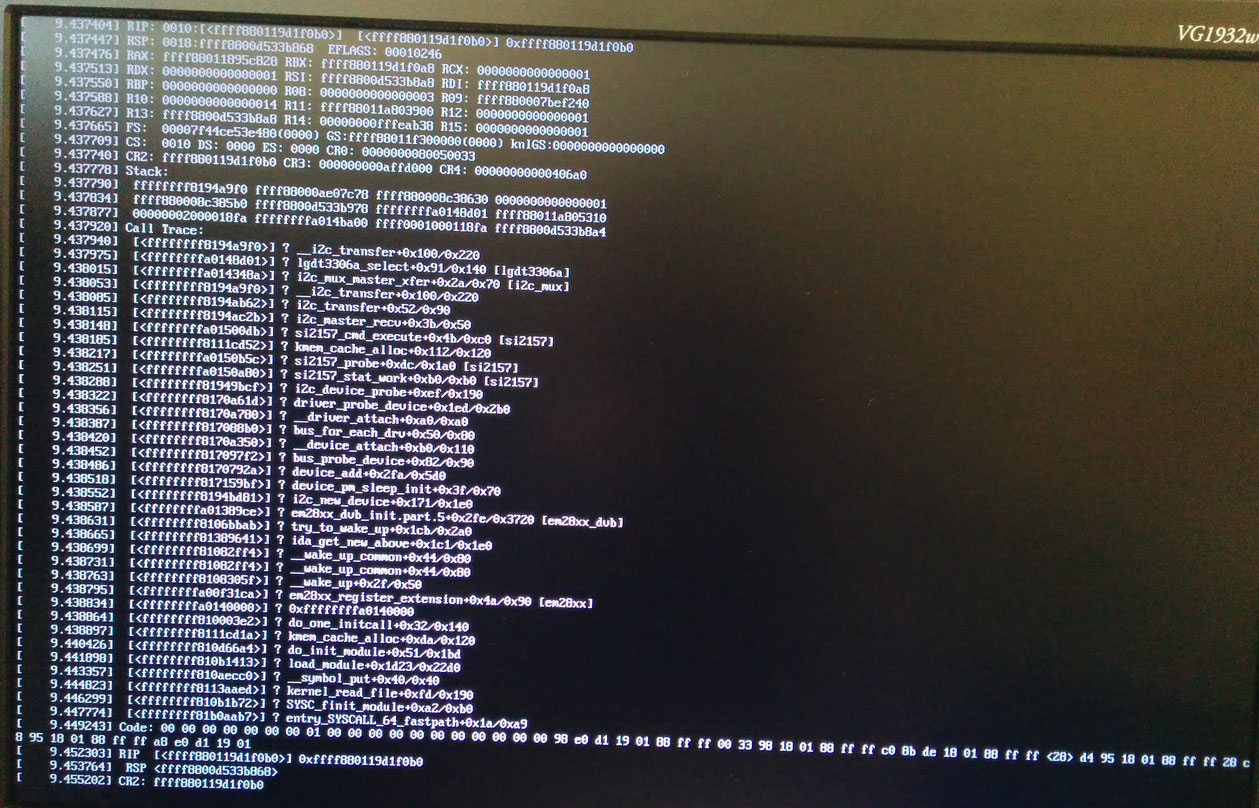

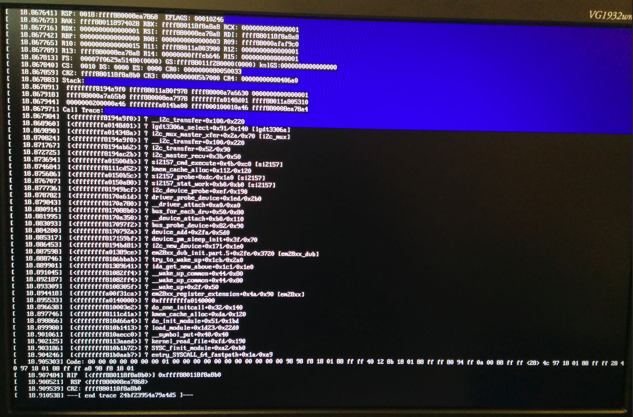

    The other behavior I've noticed when this tuner is plugged in is I cannot reboot or shutdown the system. If I do either, I get a black screen with some text, and I have to push the reset button on the machine. I've noticed similar text when trying to install LibreELEC on my machine with the tuner plugged in. I can still manage to install the system, and it seems to run fine otherwise. I've tried having the card plugged into USB 3.0 and 2.0 ports, and I've removed any extension cables between the tuner and the PC. I'm also using the USB ports on the back of the motherboard. If the card is not plugged in, neither the shutdown nor the installation issues are present. I've experienced this behavior on two different machines with the same tuner card. I've attached screenshots of the text.
    I would really appreciate somebody pointing me in the right direction. Any ideas or constructive comments welcome!
