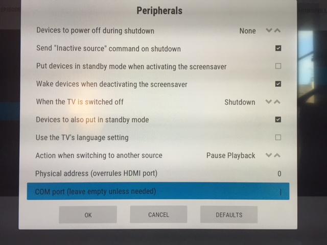

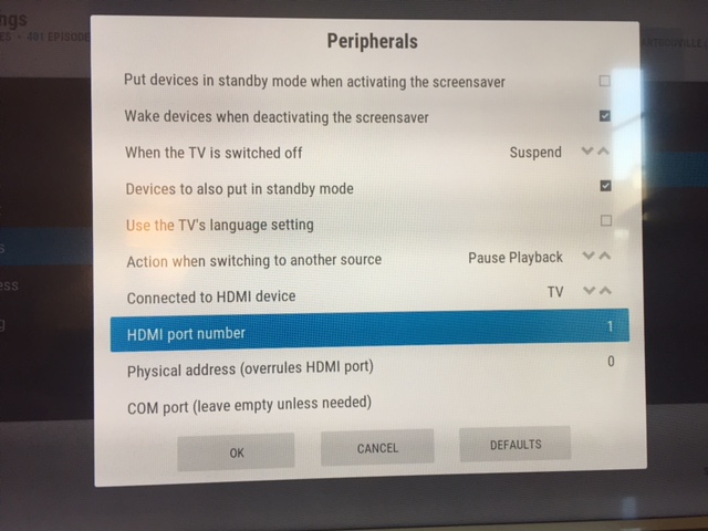

    There is a Pop-up “Pulse-eight CEC adapter: Configuration updated”
    Device and HDMI port appears correctly :
    Change HDMI device to “Amplifier” and HDMI port to 2
    Clic OK
    Note: There is no popup “Pulse-eight CEC adapter: Configuration updated”
    Reboot
    The Device and HDMI port have disappeared:
    And the 2 parameters are not take into account. I must connect my kodi to HDMI port 1 of my TV, else the with "switch source to this device on startup" is ticked, it switches back to HDMI 1 port, not the HDMI port I choose.
