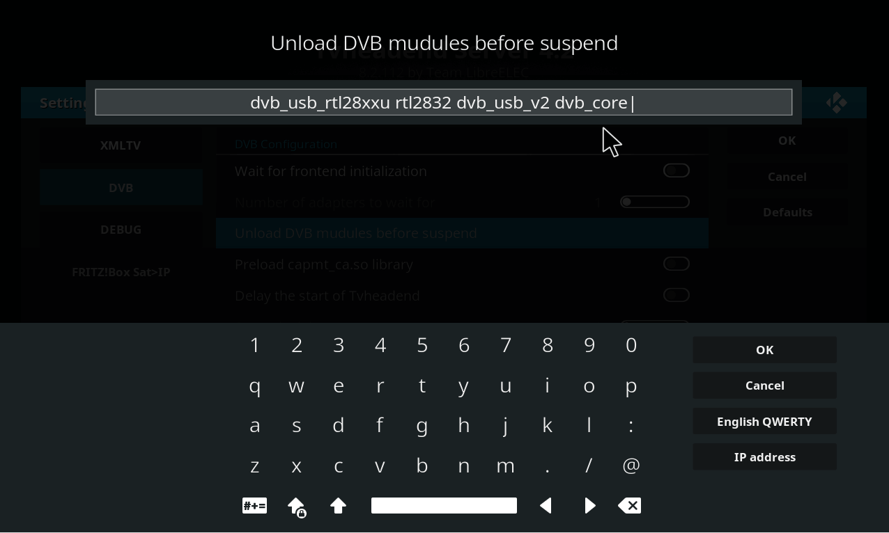

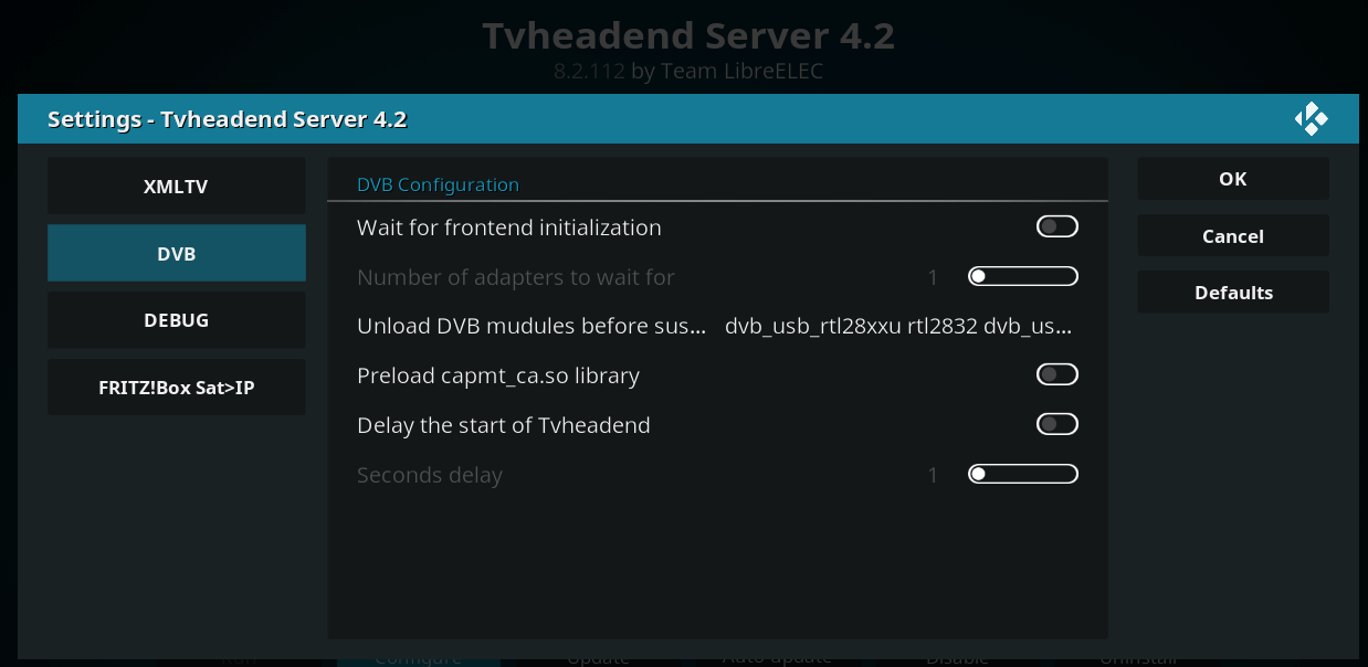

    Problem: I have a PC running LibreElec and TVheadend. All works fine, but when I suspend and then resume, there is no TV signal. Message: 'Tvheadend HTSP Client No Signal'. It's fine when shut down and restarted.
    I've followed the instructions above and entered the following modules into the TVheadend unload list - see screenshot:
    But still no good. Any ideas?
