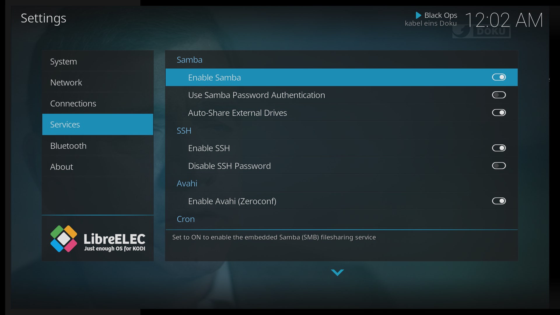

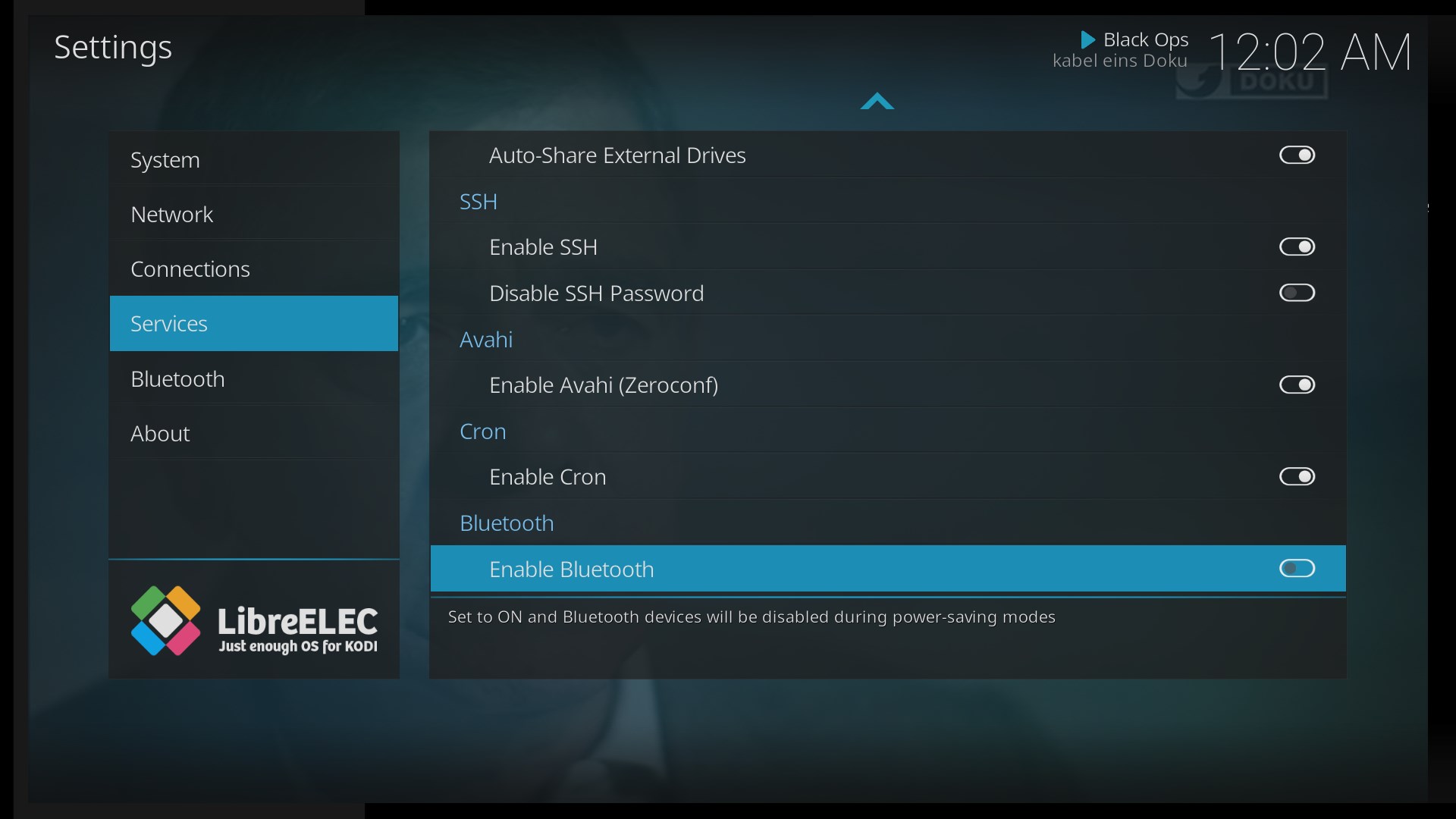

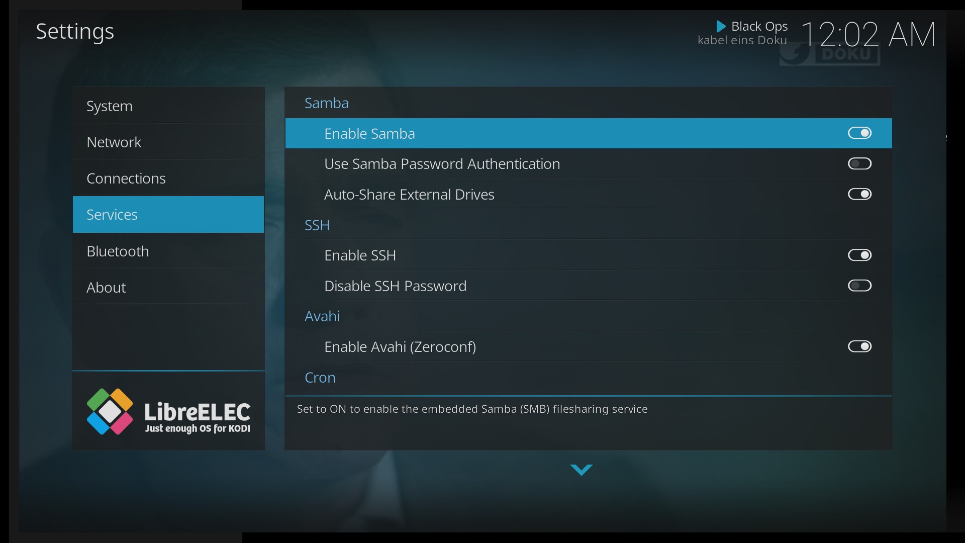

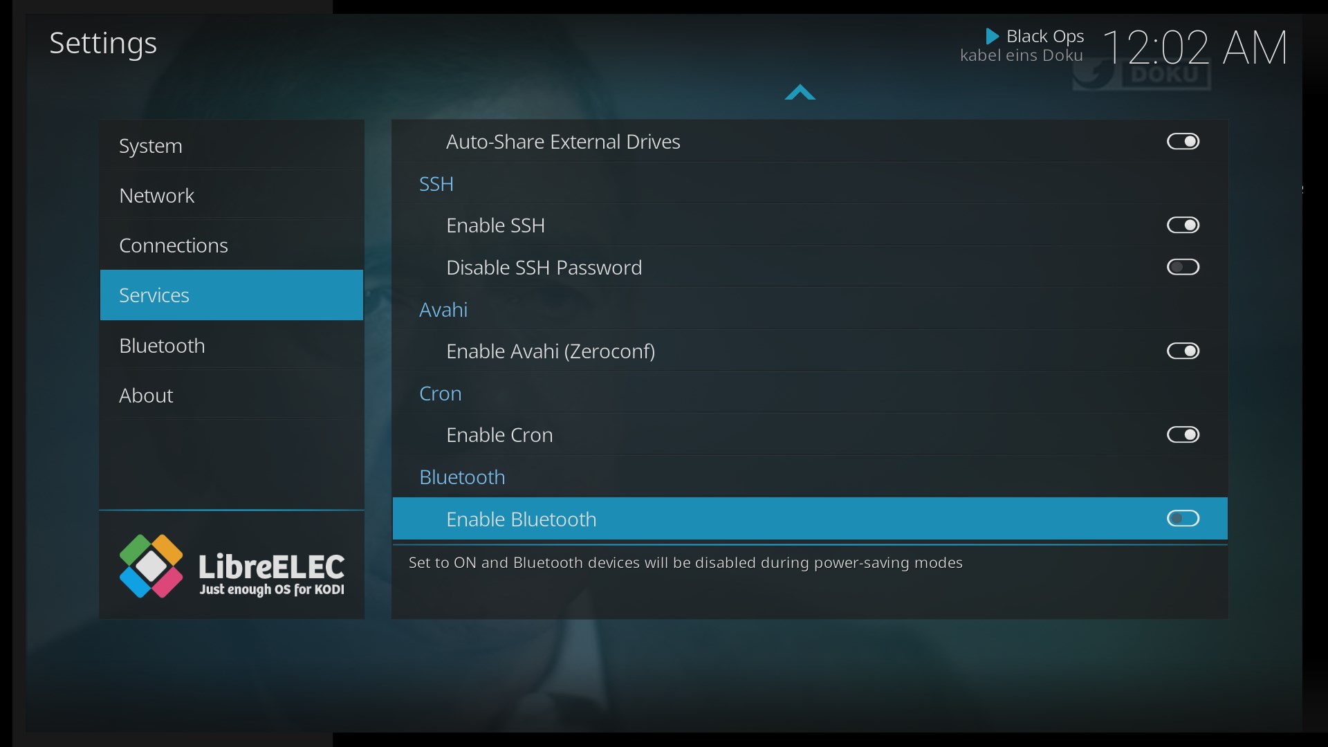

  • This is exactly the problem here. There is no option for lirc under services.
    After Bluetooth there is nothing more.
    And for the record: this is a fresh and clean install of libreelec 7.95.2 Beta.
    Here are screenshots:
