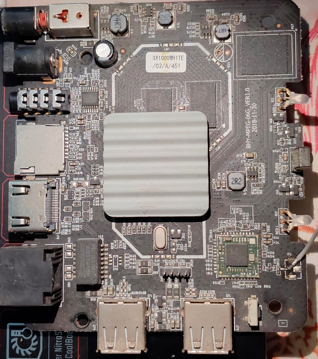

    I have a generic S905X Android TV box that is currently soft-bricked.
    Board Details:
    • Board ID: BHY-MPEG-06G_VER1.0
    • CPU: Amlogic S905X
    • NAND: BGA type (has no legs to short)
    • Reset: No physical button inside AV out.
    The Issue:
    I flashed Aidan's Universal v9 (S905X) using USB Burning Tool using USB C to A cable. The flash completed 100% successfully. However, upon reboot, I get a Blue Screen / No Signal on HDMI.
    The PC fails to detect the device in Amologic Burning Tool, even when I try shorting the Golden Pads shown in the photos.
    What I Tried:
    1. SD Card Boot: Created a bootable SD card using Burn Card Maker. Nothing happens.
    2. Shorting: Since the NAND chip has no legs, I cannot short the pins there. I rely on the test points on the board?
    Can someone help me find the correct Test Point / Shorting Pin for this specific BHY-MPEG-06G board?
    Is there a specific resistor I need to short to force Mask ROM mode on this PCB layout?
    Or is it dead dead?
