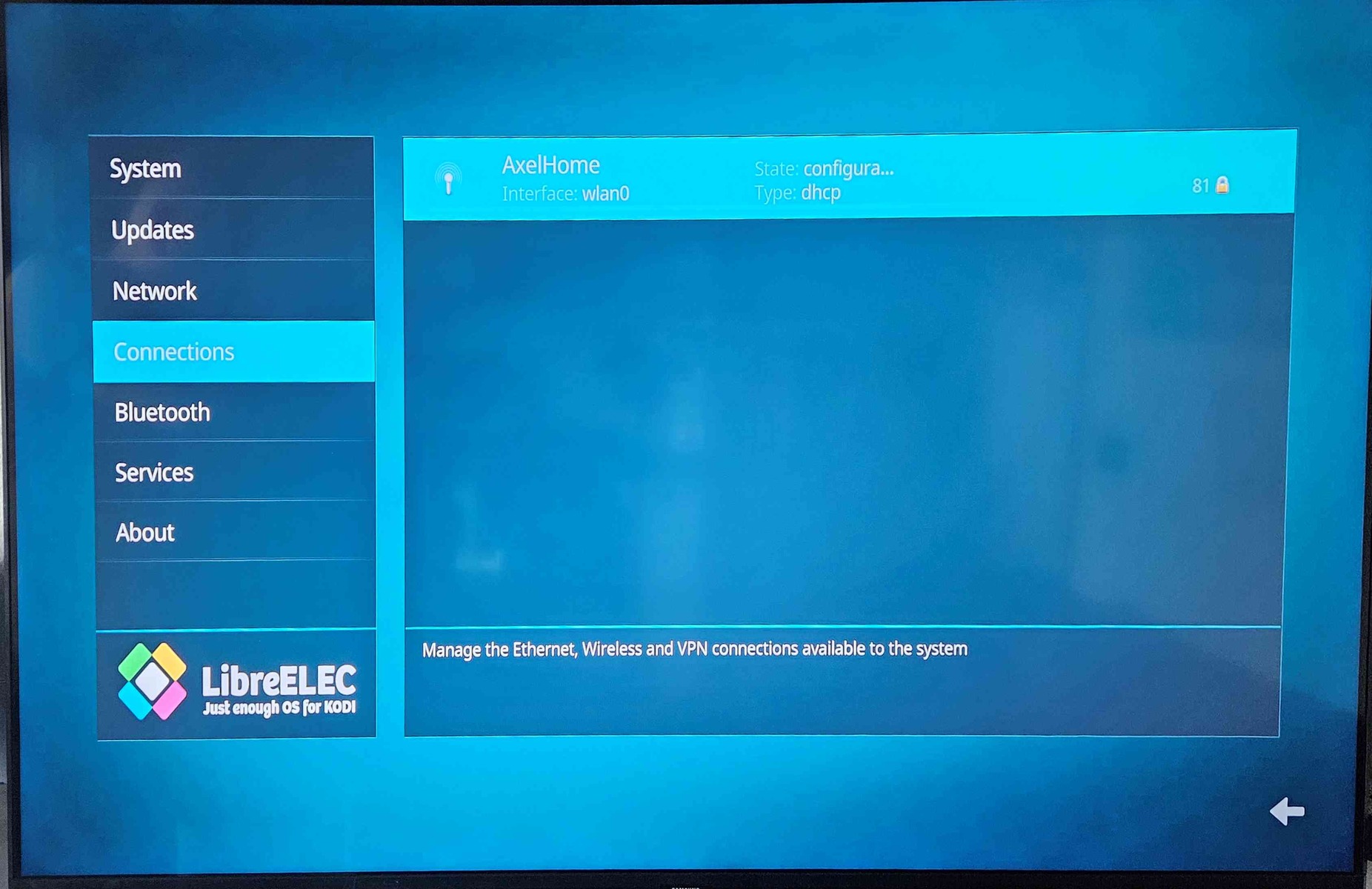

    Thanks for sharing those info's, but I'm unable to get kodi working after updating or even after a fresh install of your image,
    maybe I did something wrong, here what I've done.
    • This is the image I've have downloaded, https://chewitt.libreelec.tv/testing/LibreE…-12.90.1.img.gz
    • After updating the system at first boot system got stuck, so I restarted manually and got a whatchdog on CPU1
    • After that I've tried to make a fresh install, was able to get to kodi interface and finish the libreElec configuration,
      but as soon that I try to configure the Wifi, just after inserting the password and pressing enter LibreElec just freeze,
      First time I've tried with the lan cable inserted, second time without it, but the result is always the same, Librelec freeze.
