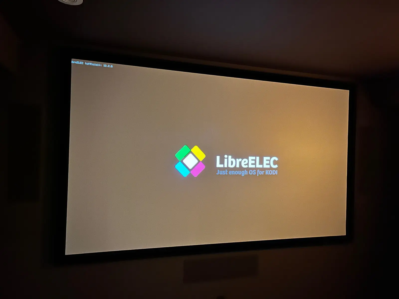

    My last two attempts to update to 12.2.0 have failed and when the RPi reboots after the update process the system hangs at the LibreElec splash screen.

    I've no idea what the problem could be, but if you see the splash screen the OS has booted and should be running. However Kodi has not started and thus nothing gets rendered over the splash screen. If you add "ssh" to kernel boot params in cmdline.txt the SSH daemon is forced on and you can probably SSH in to capture the log from the device. Or the Logfiles SMB share might be accessible over the network.
