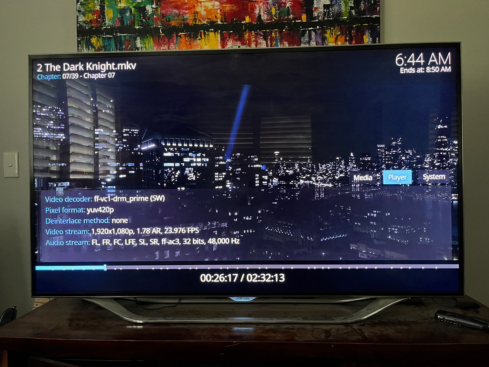

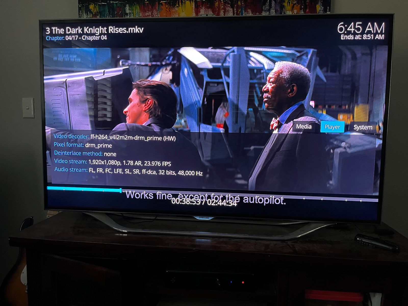

    My son decided to watch a show I had ripped from BluRay to the file server in the kids room. He told me it looked ‘glitchy’ and sure enough when I went in and examined, it was unwatchable. I hit ‘o’ to examine the stream details on Kodi and it indicated ‘ff-vc1-drm-prime (SW)’ which to me says that it is being software decoded (Pic 1). I tried several other shows where hardware decoding is working and the movie plays fine - Pic 2 is an example ‘ff-h264_v412m2m-drm_prime (HW)’.
    From this I inferred that VC1 encoded files would fallback to software decoding and not work whereas H264 encoded files would be hardware decoded and play fine. Testing confirmed that this is accurate.

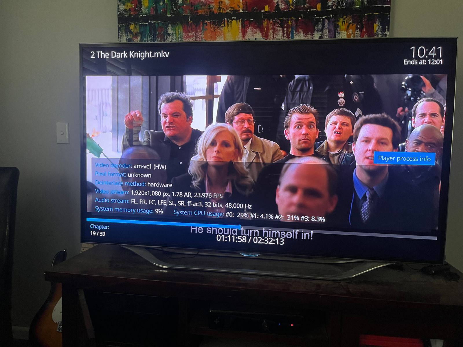

    The thing is that BOTH codecs used to play with hardware decoding just fine on the C2 before I upgraded. To confirm this, I flashed an old version of Librelec Leia onto the C2 and tried playback of a VC1 encoded file again. Pic 3 shows that with this older version of Libreelec, hardware decoding is enabled and plays fine ‘am-vc1 (HW)’.

    The upstream Linux kernel used in LE10+ images does not support VC1, the driver has simply never been written. It does exist in the older vendor kernel used in LE 9.2 and older images, but as you found, these days these have issues with TLS certificates (can be solved with a custom image) and general add-on compatibility. There's about 0.01% code in-common between the upstream and vendor kernels and Kodi removed support for amcodec (and all the other proprietary codec methods) a long time ago now so the options are rather limited. AMLGX is self-admittedly a bit of a compromise and not as feature complete as older images. There has not been much development on the codecs for a few years and they are what they are. I would recommend re-encoding to H264 as the decoder for this is in quite good shape and more family-friendly. You can also re-encode to HEVC, but this driver was never fully completed and it has glitches, e.g. seeking is not brilliant. Anything more needs new hardware.
