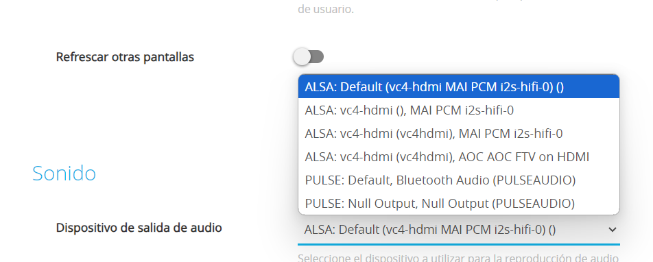

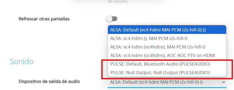

Thank you very much for the suggestion.. I will try again with Snapcast. Actually, it did work, but I was only able to get it working properly once. After restarting LibreELEC, it stopped working. I think it might be due to the audio output configuration. In Snapserver, I set the source to 'Kodi,' but when I go to the system settings for audio output, I don't see 'PULSE: snapserver' in the list. It only appeared once, and at that moment it worked, but after that, I no longer see it, and only physical devices like HDMI and my HiFiBerry are shown. I'm not sure if it's related to Snapclient, as the audio device is also listed in the configuration there... I don't really understand what's causing this. Sorry for my English... I'm not very good, and I'm using a translator to help me.
