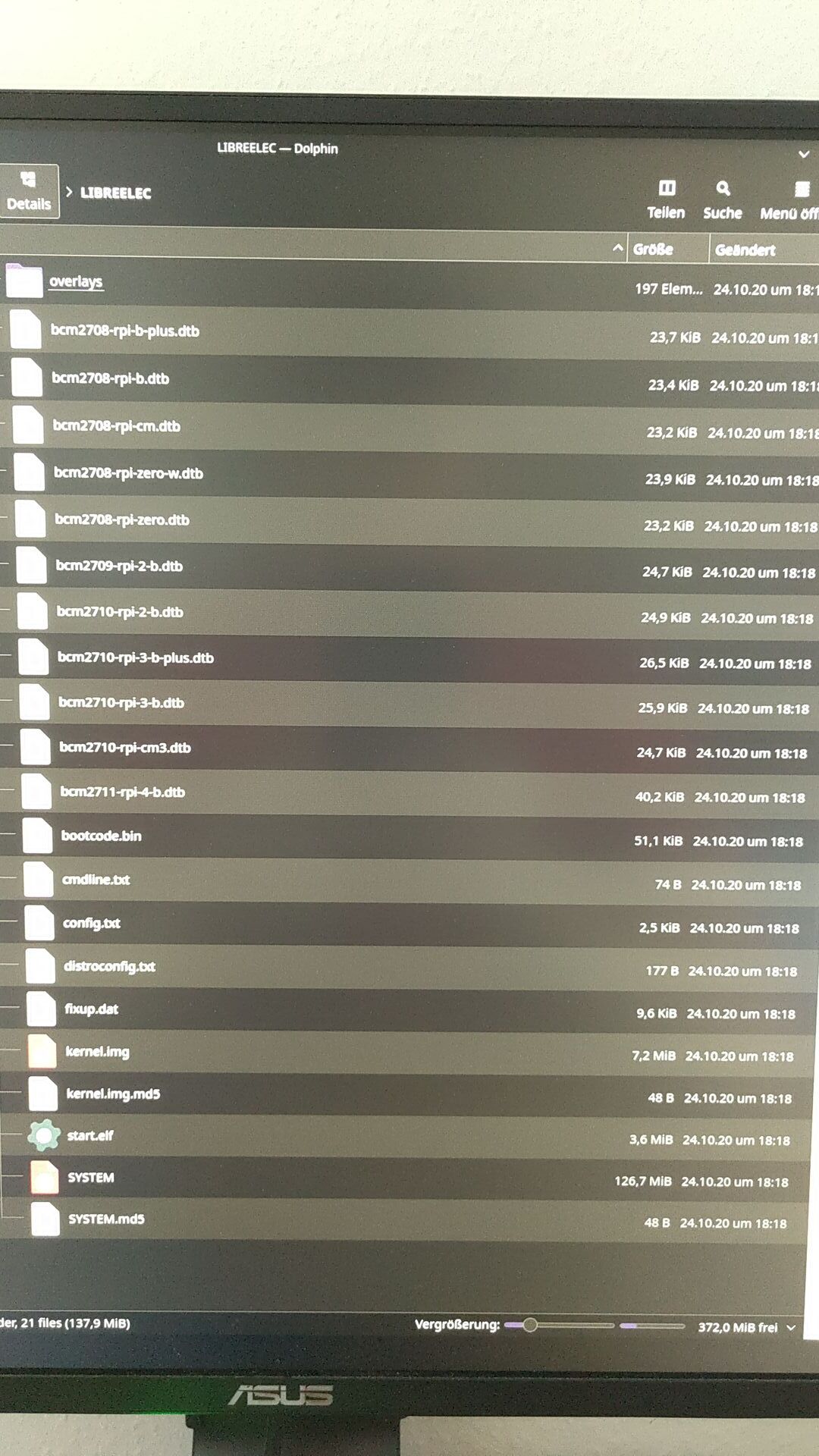

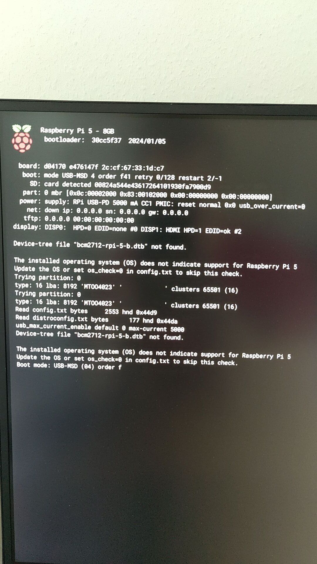

just this weekend i was trying to install libreelec on a raspberry pi 5 on a SD card. The problem is that it wont boot. The problem occurs doesn't matter which version I use.
Tried images:
- latest stable LibreELEC-RPi5.aarch64-12.0.0.img.gz
- nightly builds https://test.libreelec.tv/12.0/RPi/RPi5/…-405b31e.img.gz
- nightly builds https://test.libreelec.tv/13.0/RPi/RPi5/…-fe8535f.img.gz
Tried software
-libreelec USB-SD creator
-Raspberry Pi Imager
What did I wrong or is something missing in the images
