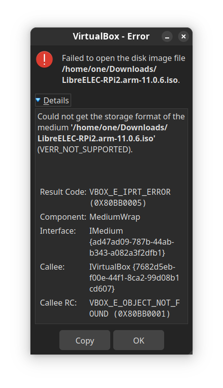

    I'm trying to get LE to run in Virtualbox so that I can do all my configuration, add-on installation and setup, etc., then convert the .vdi to an iso that I can then plop onto the few raspberry pis I have running LE. Is this even possible?
    I have the latest rpi2/3 img.gz file. I've converted it to an iso using iat --iso -i  [LEfilename].img.gz -o [LEfilename].iso in the terminal, so that VB will see/load it, but that craps out with a (VERR_NOT_SUPPORTED) error, so I'm hitting a roadblock at Step 1b, and it's not making me hopeful for "my" "plan".

    You can probably run or directly import the Generic OVA image we don't support (but is available) for vmware into VirtualBox; staff are mostly using vmware but there are other people who use VB. That will avoid the need to create an ISO version of our installer .img which likely won't work anyway due to all the paths being wrong. NB: You could create an installer USB as-normal and then boot the VM from that to install to the internal VM disk (as normal) .. would be much easier.
    However the VB setup is x86_64 and your RPi2/3 boards are armv8 so even if you abandon the idea of "converting the image to use on an RPi" (which is technically not possible due to different CPU architectures) and do a simple "backup /storage and restore /storage" you will still find that there are config differences due to Intel and RPi hardware being different, and binary add-ons that you backed-up will not be compatible (due to wrong CPU arch again).
    In the end the amount of effort/energy expended trying to do this "the clever way" will be far greater than just setting up a couple of RPi boards the un-clever/normal way. Set-up one board and then learn to "scp" the important bits of /storage/.kodi to the others and you can replicate the config in 10mins per-board.
