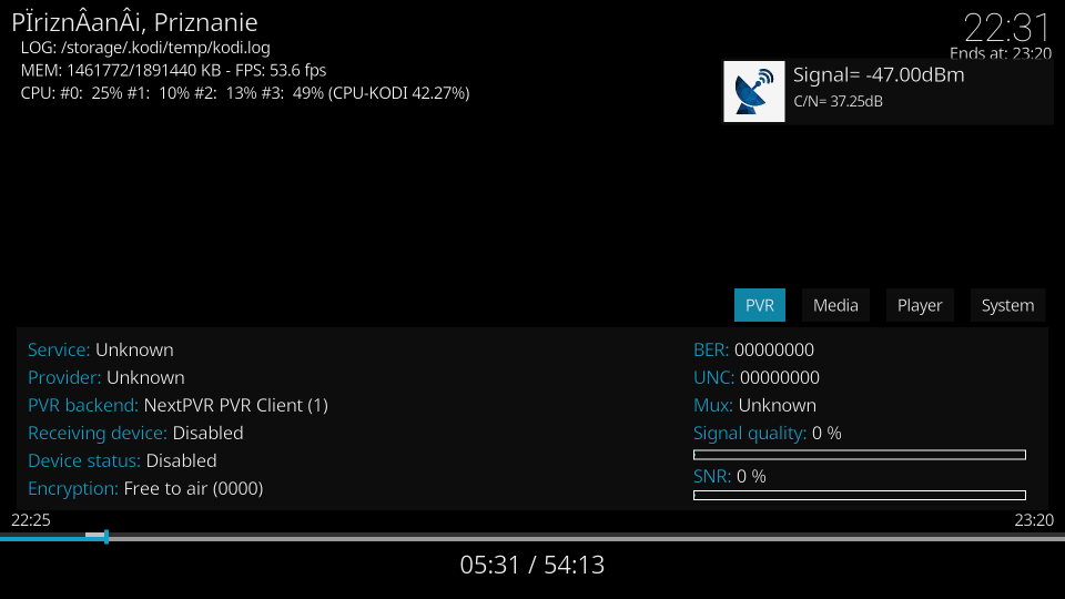

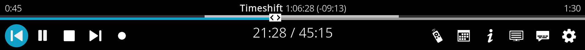

    The issue with timeshift rewind (using left key button) encountered again.
    I have found I can jump to start but only with another menu invoked by OK button, then I can't use the Left or Right butons for rewind otherwise it jumps to middle position and can't rewind to start again.
    The status of .ts files at that moment:

  • Are you using the chapter arrows in PVR? They don't seek by time, their seeks are EPG based. I made this video a couple of years ago on an RPi4 with seeking on the timeline not on the arrows, excuse the sound I messed up OBS.
    The add-on doesn't really control what the GUI does, it just passes requests to the server.
    For clarity the other thread was about the nextpvr service addon and this so far is about pvr.nextpvr addon.
    Probably not as I don't know what it is and how to use. :)
    Simply using Left and Right buttons on my IR Remote control.

  • Probably not as I don't know what it is and how to use. :)
    Your second image shows you using the chapter prev button, you need to move focus to the timeline on the light grey sliding scrollback buffer to skip properly. I thought I posted the link from the RPi4 earlier, in ite you can see the I bar cursor moving on the timeline
    External Content www.youtube.com
    with the remote.
    Out of curiosity are the channels you are having problem with h265 (as shown in that error)? Also sre you switching to and from DVB-T and DVB-T2 on the same tuner?
    Here is the error in the dvbv5 front end subsystem. https://git.linuxtv.org/v4l-utils.git/…5/dvb-fe.c#n522 it isn't coming from NextPVR
  • The "second image menu" I usually don't use for timeshift navigation. It was just last chance I have found, 'pushing' the highlighted button (didn't know it's chapter prev) to get back to timeshift starting position (very left) like it's visible on third image.
    Usually (when it works like should) I am just using Left (arrow) and Right (arrow) on my remote control which opens the timeshift bar on display top like it's visible on first image. And moving inside the timeshift window back and forward with these two keys.
    Yes only HEVC (h265) currently, don't use old DVB-T channels in mentioned issue examples.
    Edited once, last by ghtester (June 8, 2023 at 2:20 AM).

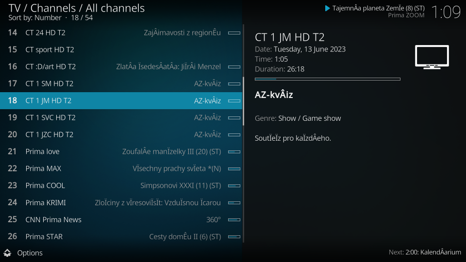

  • Thanks, my system is totally fake streaming from your fullmux in a loop as dvb-t but this test is on an lesser machine than an RPi4 (CE20 S905X4 with the Sony tuner on Astrometa) but I can't get tuning to fail https://imgur.com/a/IdE7s2d (you need to enable sound on imgur) Does tuning work on the same mux for you? If not I might need to try the same test on an RPi4, since your messages appear to be kernel related.
    Note in the video I did import one channel using XMLTV to get proper text. Sub is looking into your problem and if you want to use XMLTV I can help you out there in the meantime.
  • No, even the channel change to another on the same mux fails. So it's probably some configuration different from defaults (on NextPVR service/client) which make troubles. I need to restart the service.nextpvr to be able to open any channel again.
    BTW. there must be more things wrong as I don't see any info about the Service / Provider in Kodi (when the LiveTV channel is playing properly).
    The EPG texts on your video are also improper (the same bad diacritics like I see here). It's somehow readable though so it's not the major issue.
    Edit - Huh, the tuning now works. What I did? Tried to force updating EPG as the NOVA channel did not still have any EPG info. So I tuned to NOVA channel in Kodi, in NextPVR web GUI invoked EPG update which interrupted playing the NOVA channel but now I am able to tune... EPG Update is still running and scanning all frequencies (don't know why it now scans all frequencies and sometimes only 1 frequency). It's interesting no EPG update happened as some channels (including NOVA) have it empty still.
    Edited 5 times, last by ghtester: Merged a post created by ghtester into this post. (June 12, 2023 at 10:17 PM).
  • The data screen is not supported in either pvr.nextpvr or the API to the backend. never saw the point to implementing providers as it is mainly cosmetic. The signal strength info can be of value but only for digital tuners and is not multi-platform and is sometimes incorrect. I know when my signal is bad by watching but no doubt technical users who are used to it will miss it.

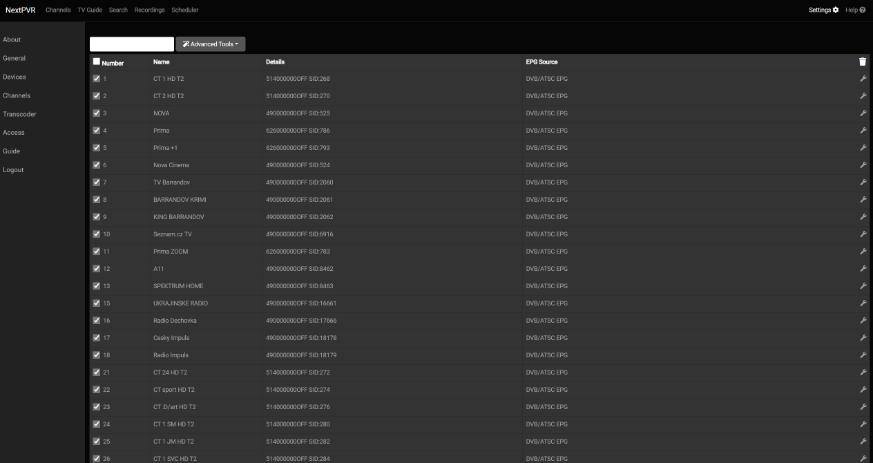

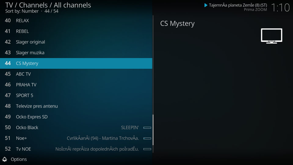

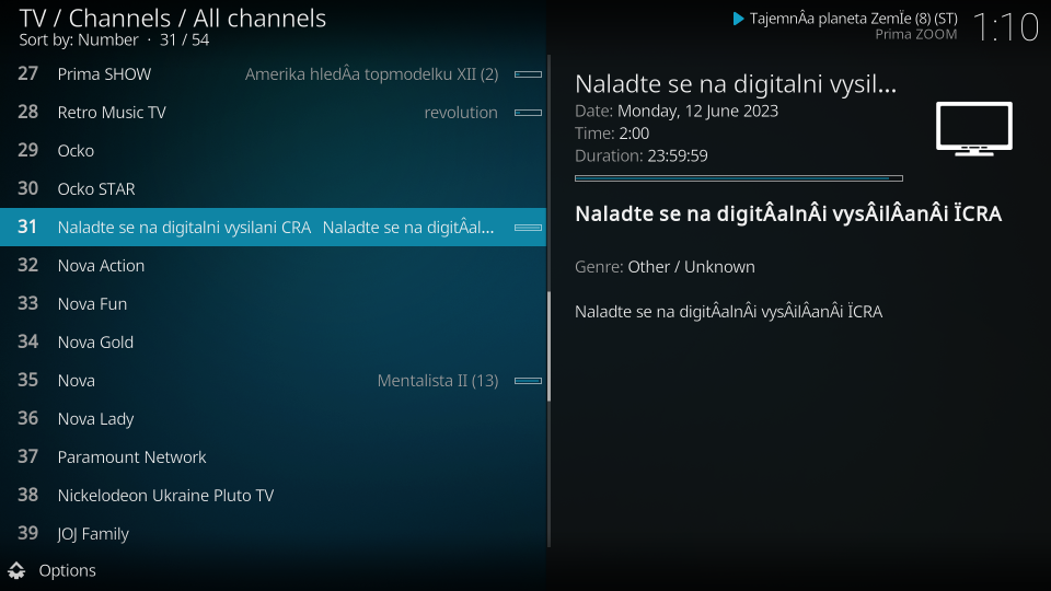

  • I add your 490 fullmux and I don't have any problems with NOVA. https://imgur.com/a/nTEOQXd Do you know any channels that don't provide data that should?
    Please look at the screenshots where you can see the channels with empty EPG (not all of them are provided but at least several of them should)
    BTW. I have different channel numbers, AFAIK first 11 I have changed manually (edited channel nuumbers to have the prefferred channels at first 11 positions in Kodi) through NPVR web GUI (but I think it should not be important regarding to empty EPG)

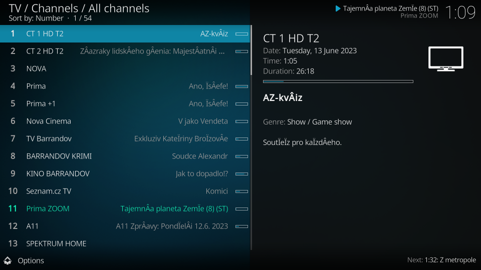

    I think sub got it to work, Kodi channel 6 is xmltv but OTA looks better now https://imgur.com/a/99TrRBZ Thanks for providing the full mux streams.
    Thanks for the update, this is correct now. :)
