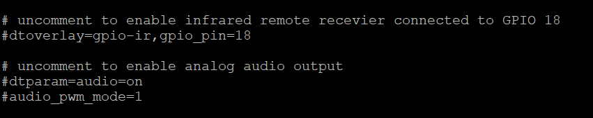

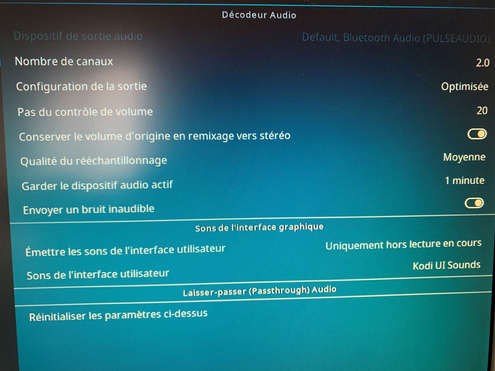

November 11, 2022 at 2:18 PM #1 Good morning,My analog output (3.5 jack) of my Raspberry pi is not working. When I go into the system settings, this one is grayed out. Can you help me?
November 11, 2022 at 3:43 PM #2 uncomment means you have to remove the "#" at the beginning of the following two lines. That part of config.txt should then look like this: Code # uncomment to enable analog audio output dtparam=audio=on audio_pwm_mode=1 so long,Hias
