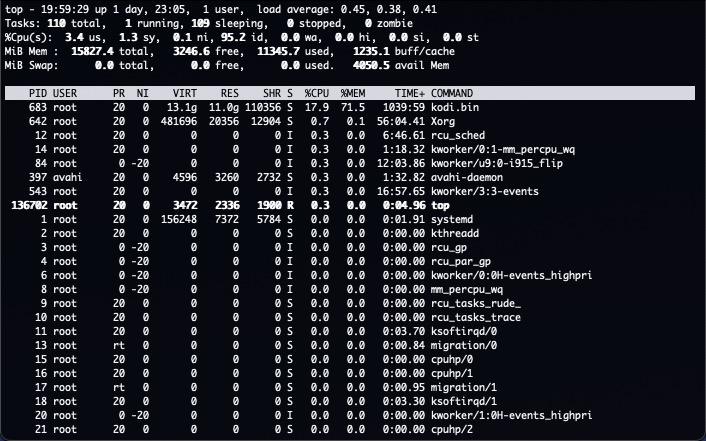

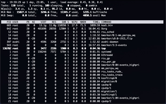

    When we are at the stage that the skipping will start - the CPU fan might be audible, debug info on the screen shows 110% CPU (one thread at 100% some of the others used) and memory usage at 85% of 16 GB. That is for idle when nothing is cataloging or playing. At that point if I start a movie it just plays with no affect to the stats being displayed… In contrast, when I restart the box we are are at 10% CPU and 5% memory usage on idle. Memory and CPU will grow over time after that.

    I have uploaded some log files (during problem, after restart, crash log from prior day). I purposely played a stereo 720p movie at x264, just to keep things as low-fi as possible with the issue happening. The issues happens when the movie called "phantom.of.the.paradise.1974.mkv" plays. I also uploaded the top screen shot at idle after being up for a few days.
