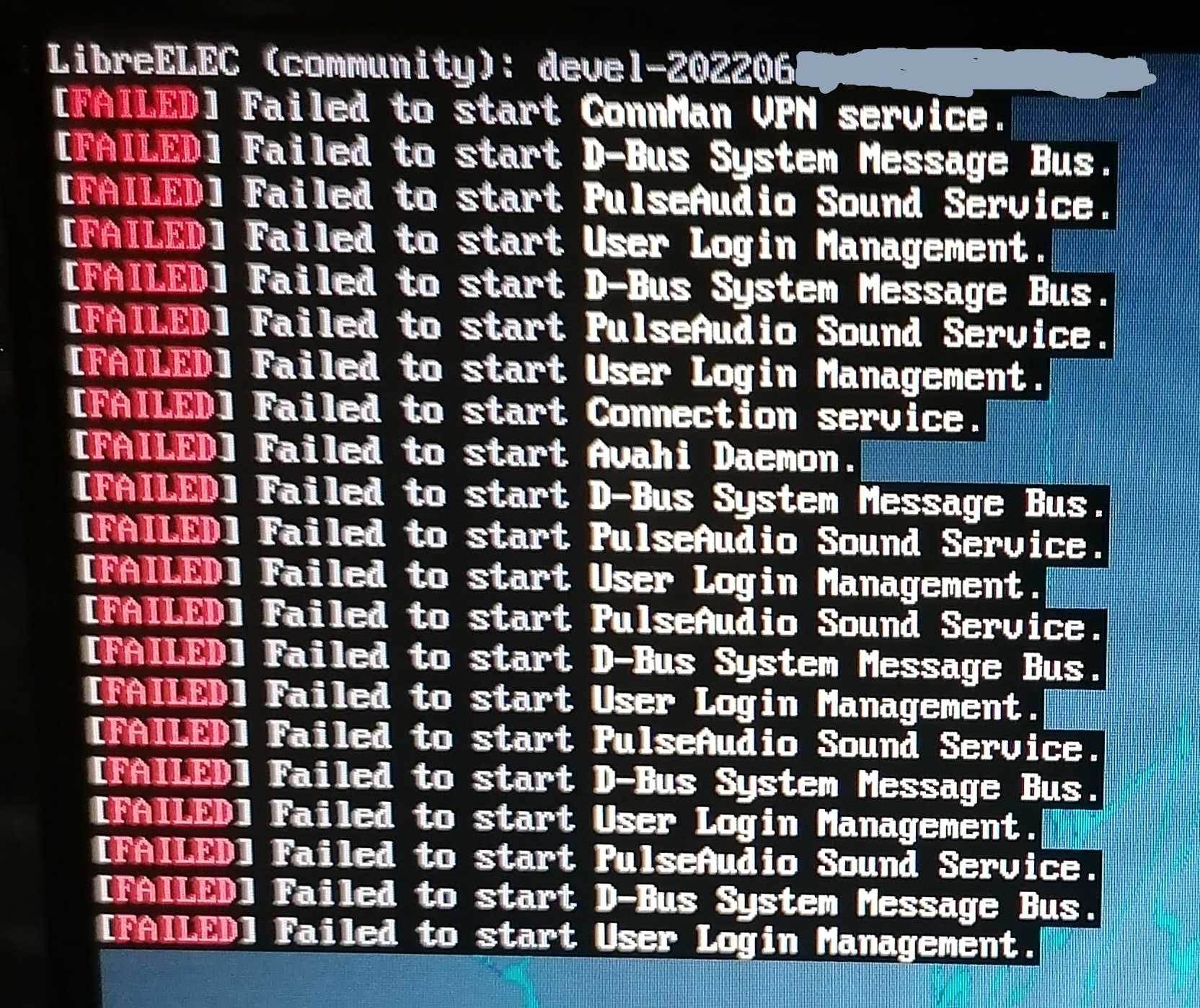

    I also wanted to try my own build LE 10 on the OPi PC, but it won't start at all - see the picture. Until recently, however, I did the building without any problems - I have no idea what is wrong (whether the problem is on my side).
  • There are also LE10 nightly images nowadays: https://test.libreelec.tv/10.0/Allwinner/ Please test if it works for you. If it doesn't, some PR probably caused an issue.
