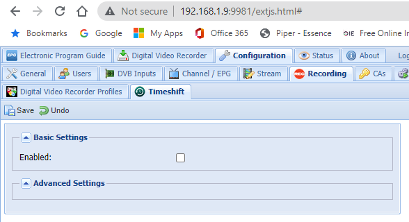

  • Hi,
    When I try to configure the timeshift buffer in TVHeadend 4.3 Alpha or 4.2 it does not hold the enablement flag.
    Sometimes the fields completely disappear, or just the Advanced section disappear - see the attached image.
    Anyone else se
    Make sure you have admin user rights on the tvheadend account you are using to change the settings...and also check the set location for your buffer if you r using a diff location rather then default...make sure tvheadend can write to that location..
