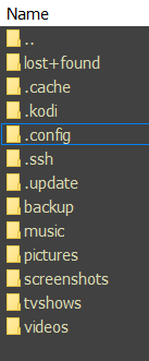

    what can i do? perhaps a hardcoded entry with the correct mountline in etc/fstab? or a script that runs at the end of the booting and tries to mount this specific sda
    until it works? but then i need assistance how to do that. :)
    my problem is: the only way i can access libreelec is via a wireless trackball (mediacenter+tv) or by editing the libreelec files direct on the sdcard on my win10 pc via adapter.
