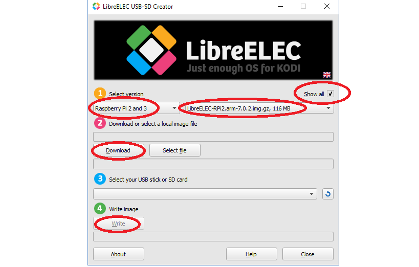

    Hi all took the gamble and I'm now running Jarvis 16.1 on LibreElec;
    simple steps;
    • download the libre elec SD Creator >> LibreELEC USB-SD Creator! – LibreELEC
    • Select Version of device
    • TICK SHOW ALL
    • select LibreELEC-RPI2.arm-7.0.2.img.gz, 116mb
    • select your USB / SD card
    • Click Write
