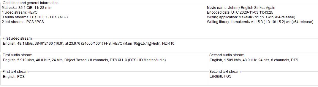

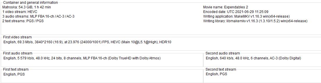

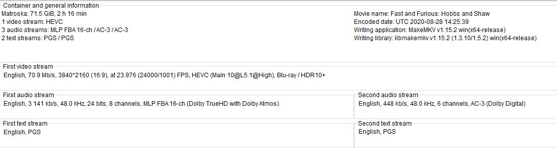

    Details of the source I'm using are in the attachments. The only difference between the two i can see is one is HDR10 and the other HDR10+.
