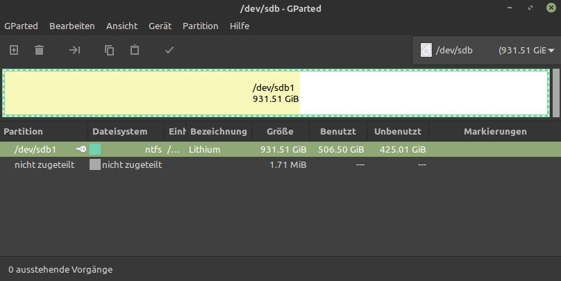

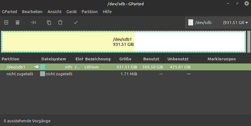

  • Isn't there a problem when there is a key icon in the partition entry..?
    Is GParted's partition check okay?
    Just checked it again, it is just an indicator that the drive is currently mounted. If I unmount the drive, the key will disappear
    Edit: also found no errors with gparted
