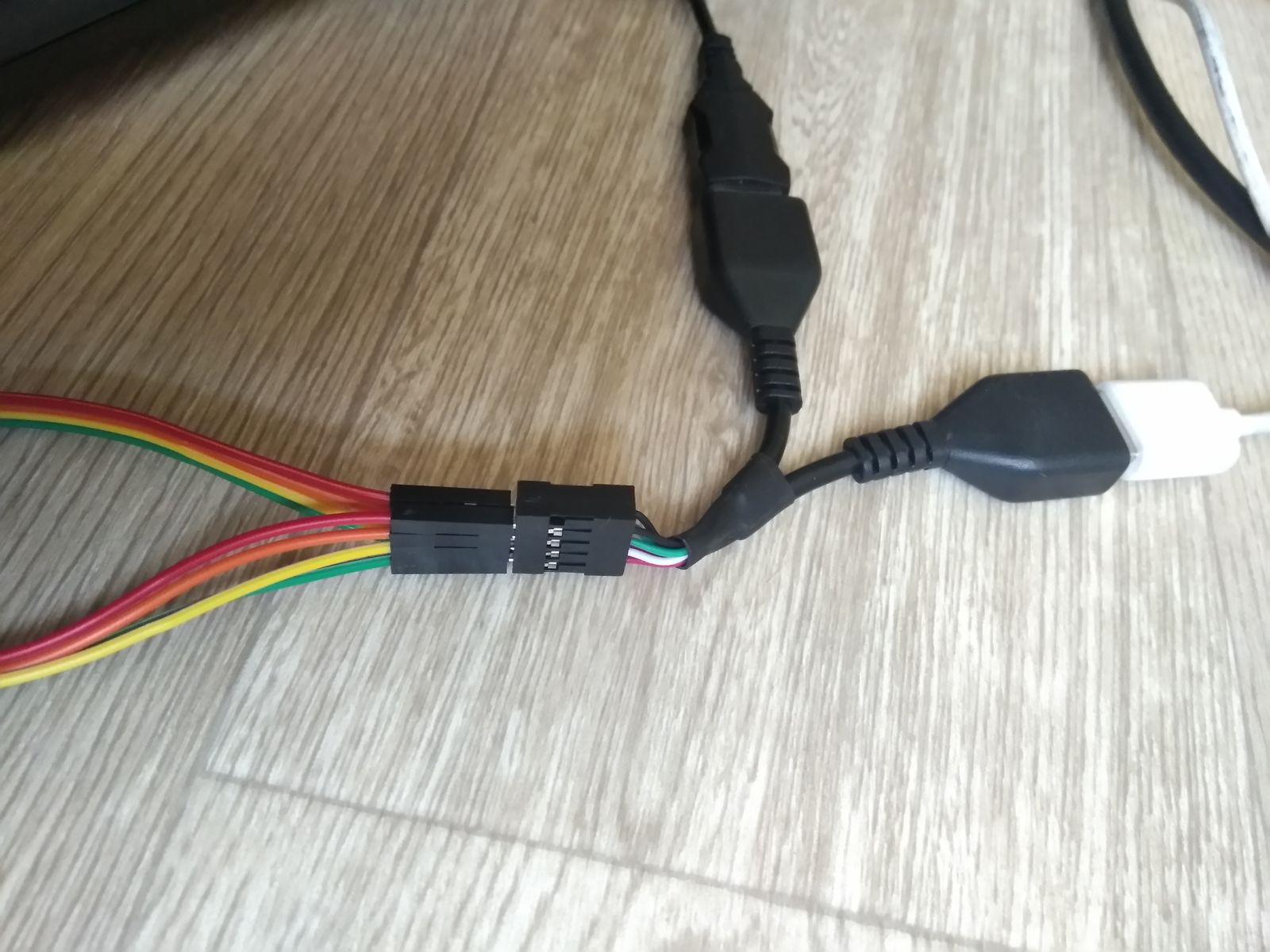

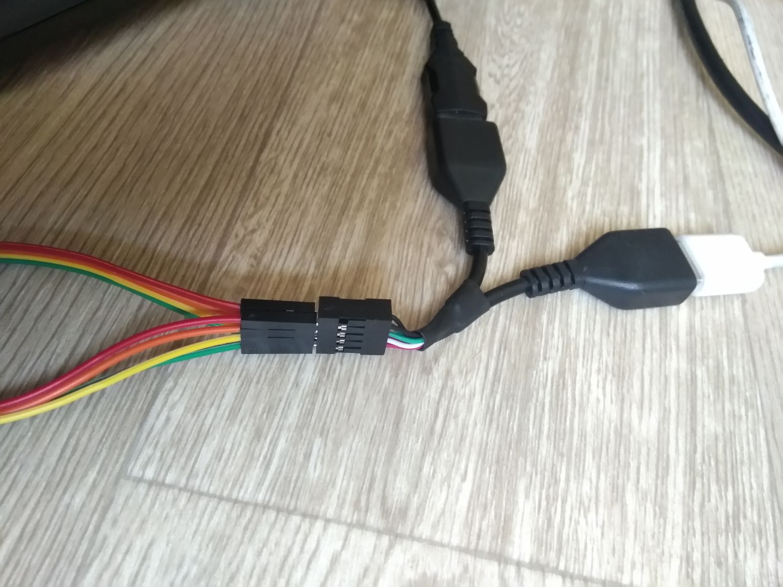

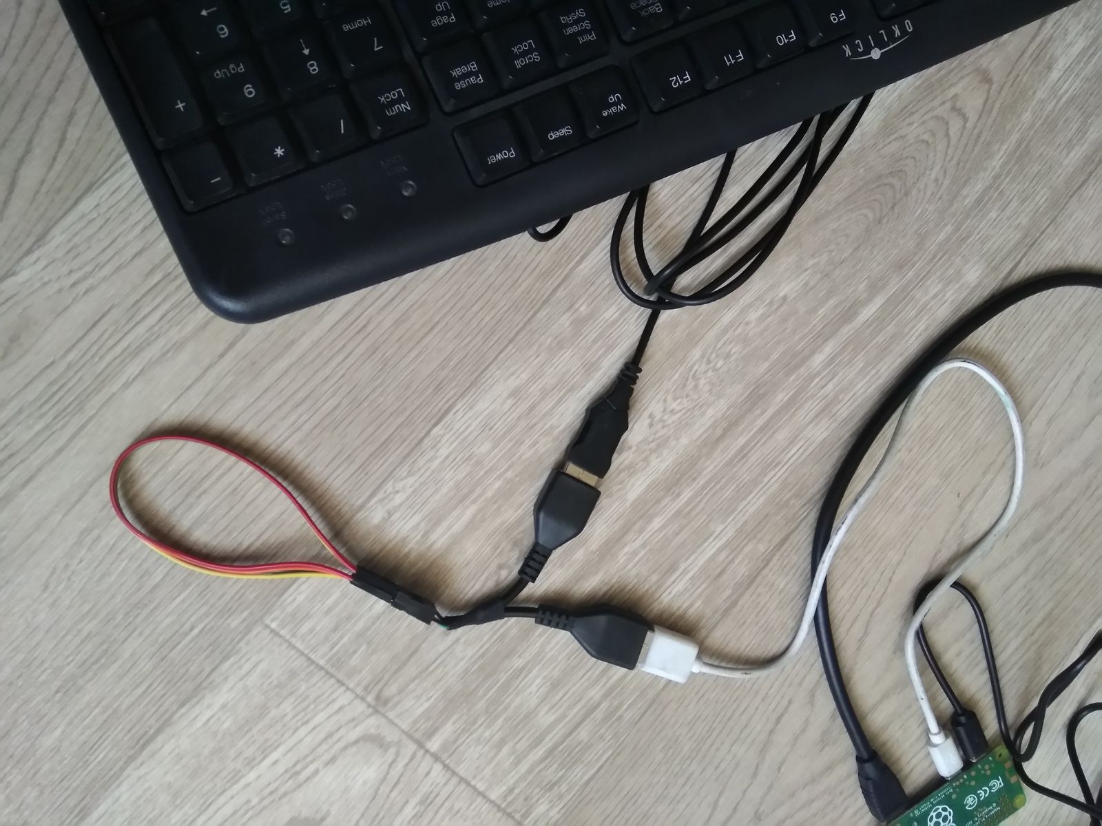

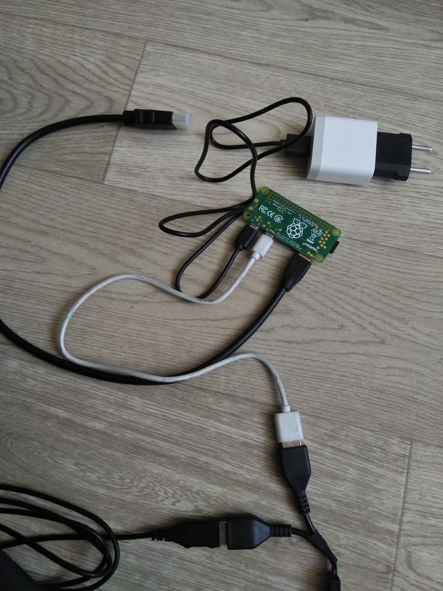

  • I could not find a mini-hdmi with CEC support quickly, but a double cable from the motherboard helped me, I was able to build an adapter with an improvised method. I set everything up, thanks.
