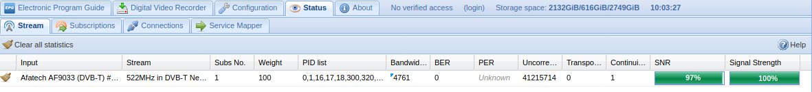

    When I plug the antenna cable on my Sony TV, everything works fine. The signal information page gives a "Pre Viterbi" of about 2e-4.

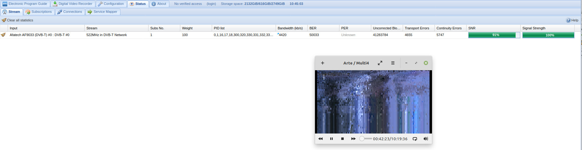

    On the computer (HTPC), I sometimes have a lot of Transport Errors and Continuity Errors. The signal is usually very good, but several times per hour, it gets totally scrambled. When this is the case, it seems to me that stopping the client and starting it again solves the problem, which is weird.
    For instance, at this moment, the program I am recording has >100000 errors.

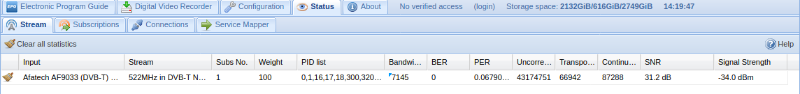

    The PER (Packet Error Ratio) is about 0.06, the SNR 31.5 dB and the signal strength -34 dB.

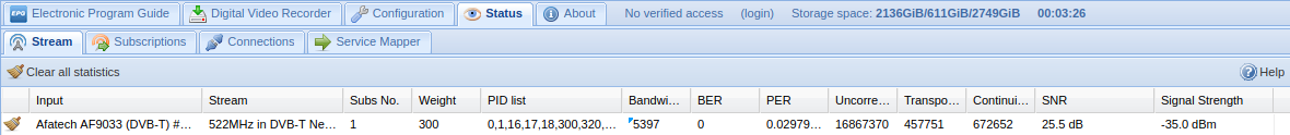

    Below are a few screenshots: in 3 of them everything works fine, but in the last one, the image is noisy.
