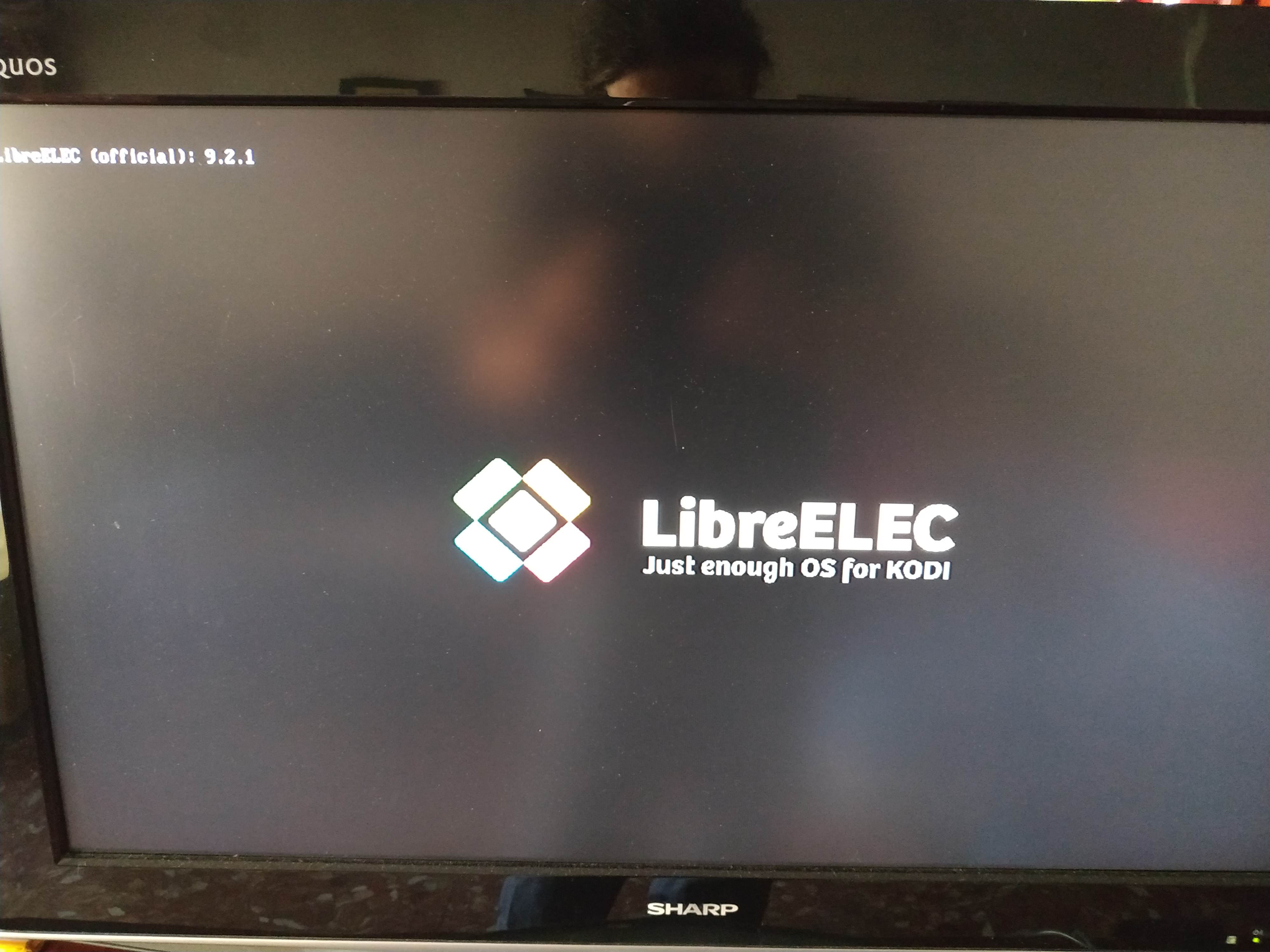

    I have my libreelec installed in a SD with noobs. It's dual boot with raspbian and libreelec (created with noobs). Everything worked perfectly but yesterday I switched off my raspberry and my libreelec stopped working. Nothing new installed (updates, add-ons, etc...) Here's a capture where is stuck. I have no access by SSH etc because didn't start the network manager etc....
  • One of the challenges with RPi boards is there is no power-off button. So 99.9999% of the time you get away with a hard power pull, and once in a while you don't. It's imposssible to diagnose the problem from that screenshot, so you probably need to nuke LE using the noobs boot manager and reinstall.
