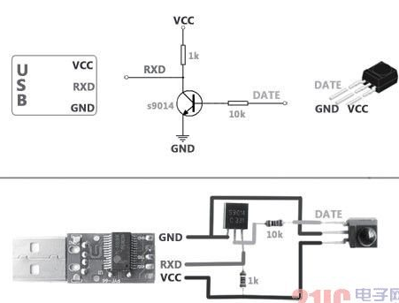

    I make an IR receiver with USB-TTL dongle.
    Already successfully remote controlled in windows.
    I try to drive it at LIBELEC.
    But unsuccessful.

    I refer to this post
    USB-UIRT configuration
    Using the driver = atwf83 formulation may receive the remote control.
    But receive code is wrong
