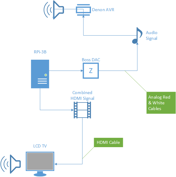

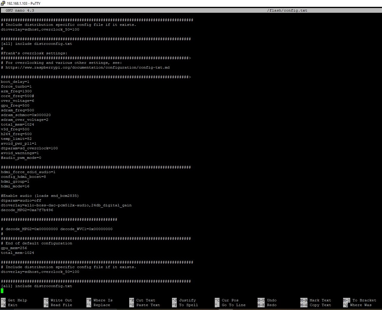

  • I have the following set up that I'm trying to split audio sound signals on.
    RP3-B
    LibreElectric 9.1.501; Kodi 18.4
    Allo Boss DAC - set up properly in config text file (see attached)
    Denon AVR receiver (receiving separate red-white audio coaxial cables)
    Vizio LCD TV (HDMI in CEC port)
    Allo BOSS set as "default" ALSA audio in Kodi system config
    When I stream music through Samba shares from my server the audio to the Demon AVR receiver works great; however, when I try to stream any type of video (PVR HDHomerun OTA signal or Samba share video files) the audio goes out through the TV.
    What I want to do is have all audio going out the DAC and use TV screen as a monitor. I'm not sure how to change this setting and where?

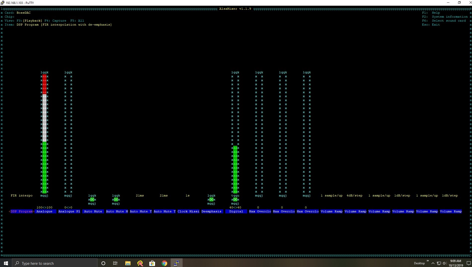

    I've checked that my ALSA is working and this is the output in SSH "aplay -l".....
    card 0: BossDAC (BossDac), device 0: Boss Dac HiFi (Master) pcm512x-hifi-0
    Subdevices: 1/1
    Subdevice #0: subdevice #0
    with SSH "alsamixer" this is the output.
    Read quite a bit in Kodi Wiki both on ALSA and PulseAudio and can't find a setting change that LibreElectric wont override.

  • Thanks for testing. Does it work when you play a video from USB stick?
    I'm asking, because I want to know whether the HDHomeRun add-on overwrites the config.txt setting, or LE / Kodi for all sources.
    Another config.txt option you could try is hdmi_drive=1. This should kill the HDMI audio completely, because it's DVI mode.

    Hdmi-Drive=1 definitely kills audio through HDMI.
