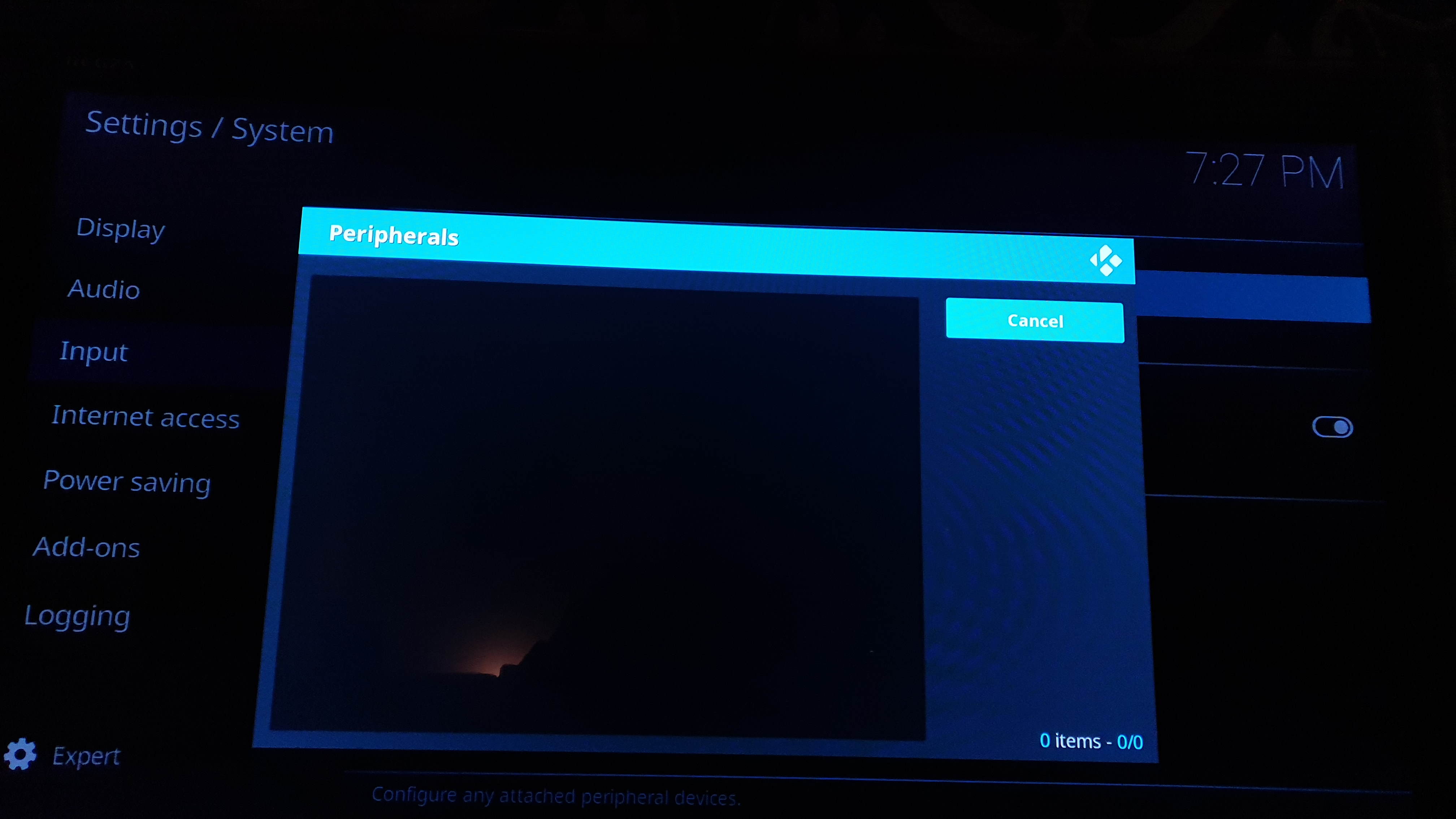

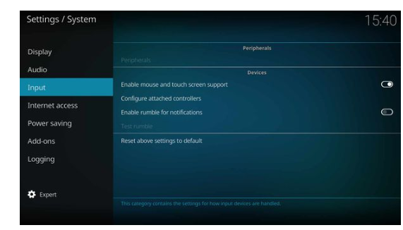

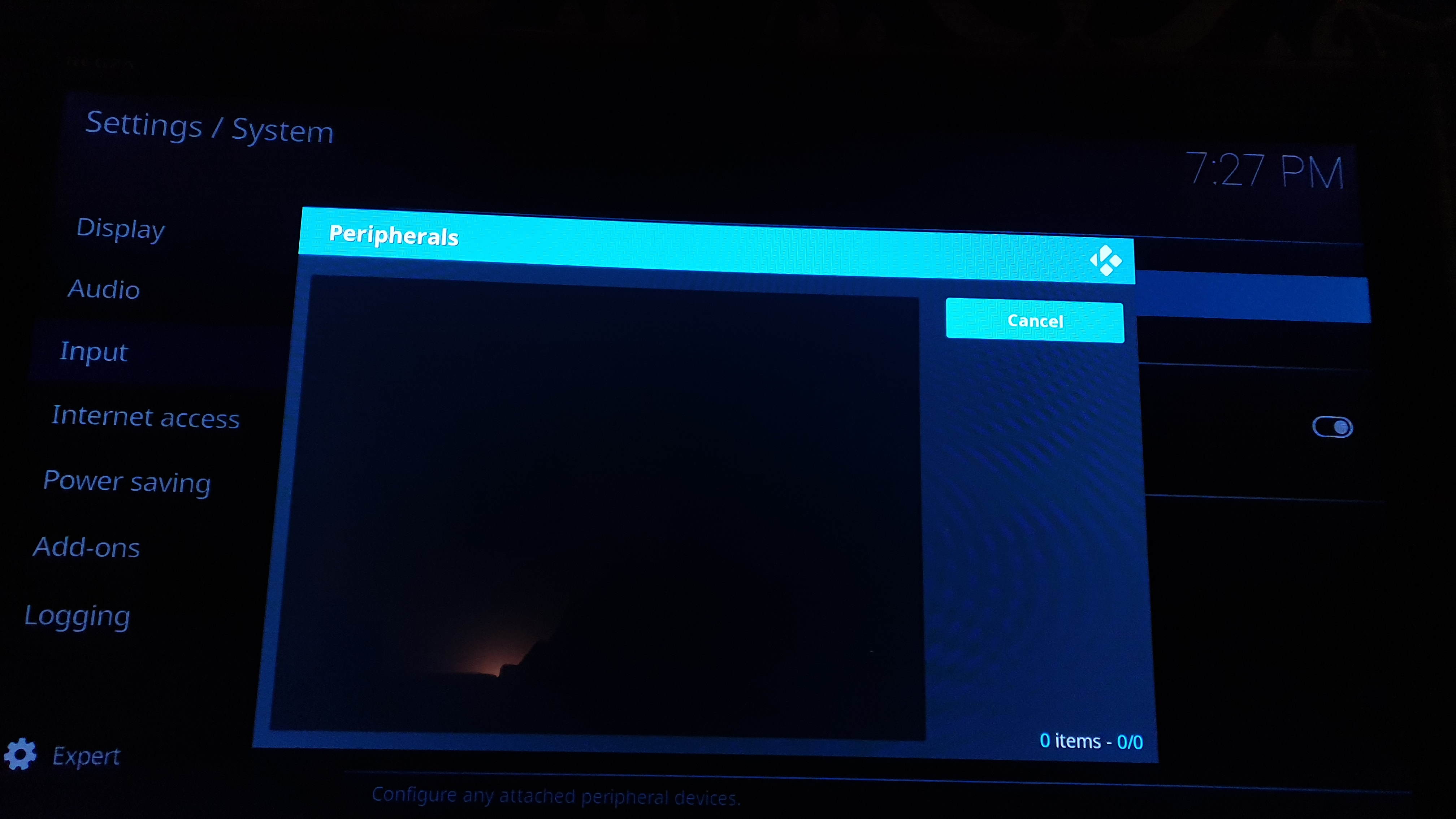

    PS: One little thing you could still try: Disable the CEC adapter add-on completely. The power button press should have no effect then. Just to be sure your PC is not responding to other signals when pressing the button.

    where can i find the "CEC adapter add-on completely"?
