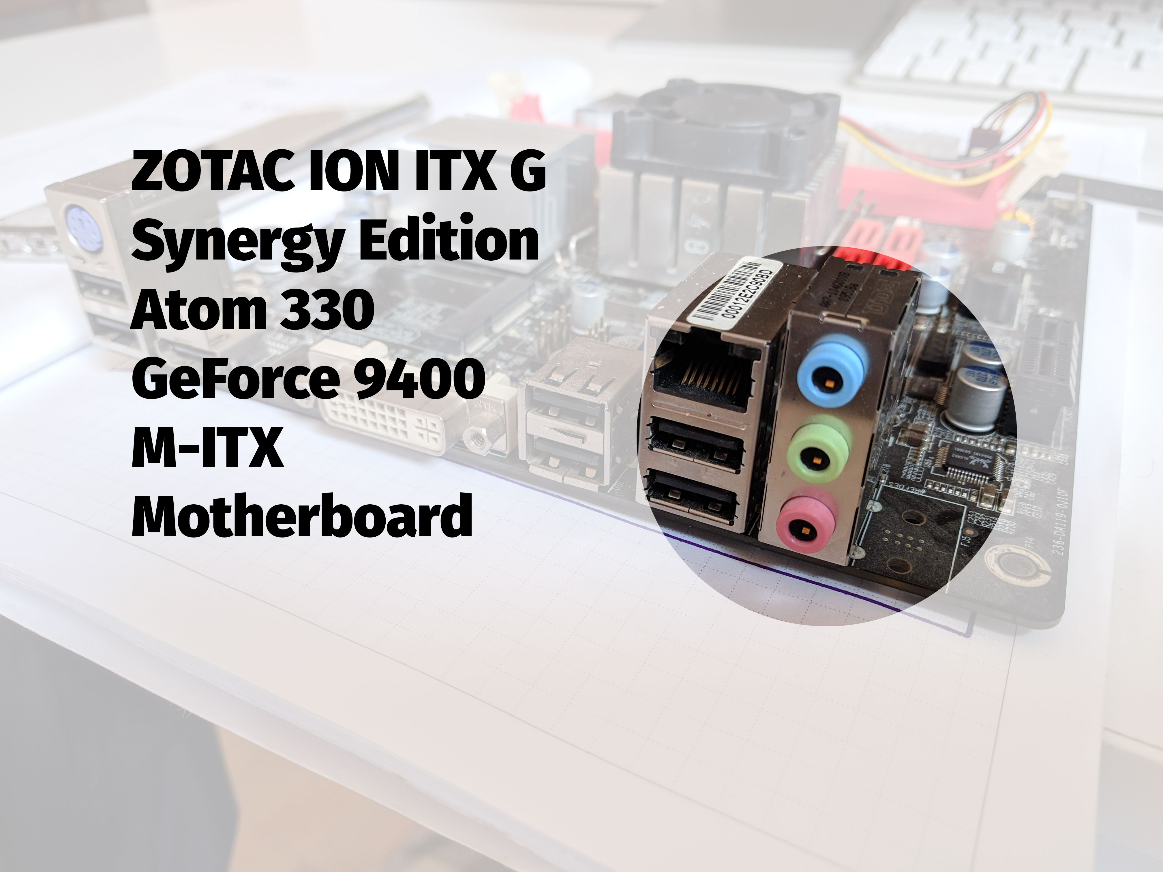

    I’ve completely finished my HTPC project and the last step was to setup a 5.1 stereo system, which failed to work: only 1 port of 3 works, two others don’t.
    All of the speakers work properly, and the problem is with my computer: either software or hardware. I assume it should be software, since there should be no reason for two port randomly be ‘broken’. HDMI works well: both graphics and sound.
    I want to try to fix this issue, but I have no idea where to start. Do you guys have any suggestions?
    My motherboard is:
    ZOTAC ION ITX G Synergy Edition Atom 330 GeForce 9400 M-ITX
    There are three ports, and only the one in the middle works.

    The MB Seems Not to Have a 5.1
    At this point someone suggested me that this motherboard doesn't look like it has 5.1 Analogue Sound. I've read on the online specification (not from the manufacturer though) that it has 7.1 output, but I assume that is from HDMI. I was very sure I've read it has both 5.1 Analogue Sound and 7.1 Digital (HDMI?), but this was from the Announcement Post years ago, even before the motherboard was released.
    So at this point I tend to believe this motherboard just doesn't have 5.1 Analogue Sound Output. While 3 jacks is enough for 5.1 (front + back + central/sub), all the other 5.1/7.1 Motherboards I have have 6 ports instead of 3.
