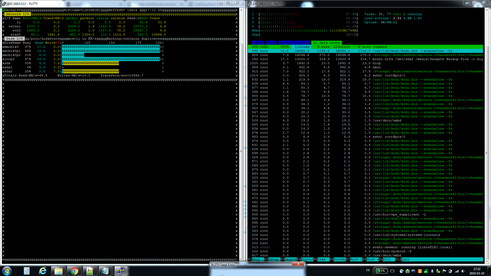

As of right now I think I may have to get something with USB 3.0 to replace my Pi 3B+ (I was thinking a Rock Pi 4) but I would like to be able to monitor or see the exact MBit/s geeing processed on usb and ethernet at the same time while recording/timeshifting etc.
Any way I can do that in LibreElec with putty?
