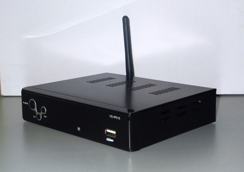

This is a LibreELEC build for g02ref/g18ref_th2 devices (Prima PM-6001, VS-IP166, VS-IP015, or other similar MX boxes)
with Amlogic AML8726-MX/M6 SoC (Amlogic Meson6).

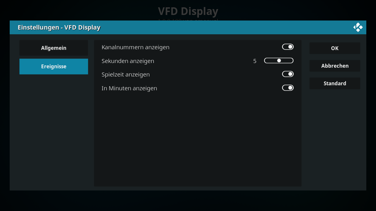

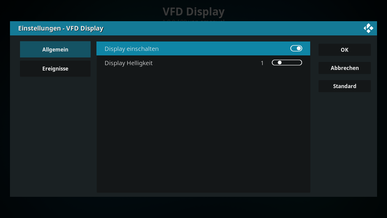

Addon VFD (Prima PM-6001, VS-IP166)

Supported devices:
It is tested on VS-IP166 (videostrong)/Prima PM-6001. If your device has different remote try connecting USB keyboard.
