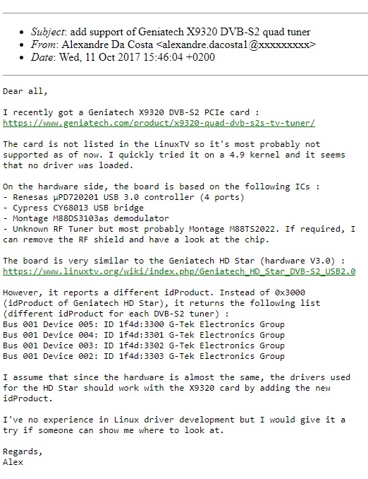

I see that the Geniatech website now shows that both Linux and Windows drivers (version unspecified) can be downloaded for the x9320-quad-dvb-s2s-tv-tuner card.
I bought the card through AliExpress and intend to use it in my pc to enable me to replace my existing satellite TV recorder with a Kodi-based system.
However, my attempts have been frustrated so far as the card came without documentation or software. After downloading the windows driver from the Geniatech web-site, the install process terminates with an "process interrupted - please try again later" error. Checking the inf file reveals that the driver is intended for use with a number of USB tuners which suggests that it may not work with the PCIe card.
this card contain USB 2.0 host controller Ic + 4x USB DVB tuners
So, finally got the card installed. The PCIe card needs an extra power supply connection and I had to get a 6in SATA to LP4 Power Cable adapter - F/M.
Device Manager shows that I now have four USB Sticks under "Other Devices" but says that the driver is not installed. Trying to install the Windows driver that I downloaded from the GeniaTech website still fails with an "interrupted process" error. This error looks like it may be something simple - e.g. an incorrect statement in the inf file.
I'm lost now - should I try downloading USB DVB-S Stick drivers from elsewhere in the GeniaTech site?
maybe windows driver not support this device, check usb ids in inf
