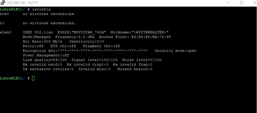

  • I have a Raspberry 3B with Libreelec 8.2.5. I have connected a Wifi Stick model Dlink DWA-182 rev c1 with chip RTL8812AU. The problem I have is that just started Libreelec the Wifi works perfectly and faster than the on board Wi-Fi chip, but after a few minutes the Wifi stops working. From the configuration of Libreelec connections it appears that the Wi-Fi network is still there but if I give it to connect it gives me an error, only by unplugging the wifi stick and re-clicking it the connection reacts. It happens even with the Raspberry next to the router, but logically what I want is to put the Raspberry further, where the Wifi Stick gives me the 50 MB / s of internet speed while the onboard Wifi stays at 12 Mb / s . I have put the Powermanagement on off and disabled the wifi and buetooth of the board, but it still fails me.

  • Sorry for the confusion of the title. It is a Raspberry 3B with Libreelec 8.2.5. The results of what you ask are the following:

    In config.txt I have the command to increase the power of the usb, thinking that the signal could be lost due to lack of power in the wifi stick, but I did not solve the problem. The error always repeats, when you start, when you restart, or when you remove the wifi stick and you plug it back in.
