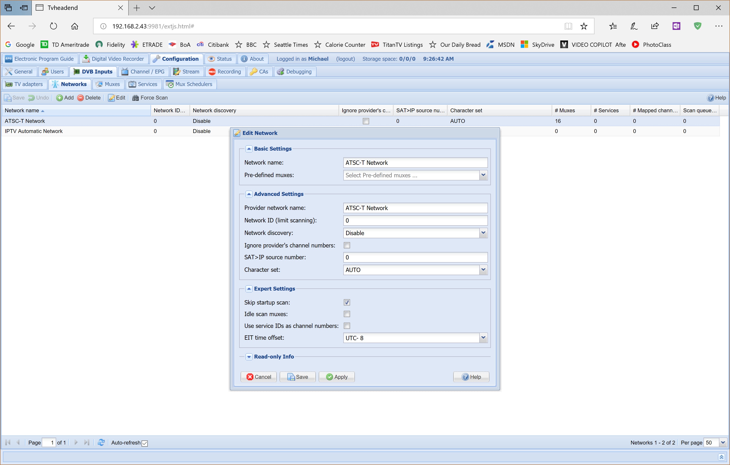

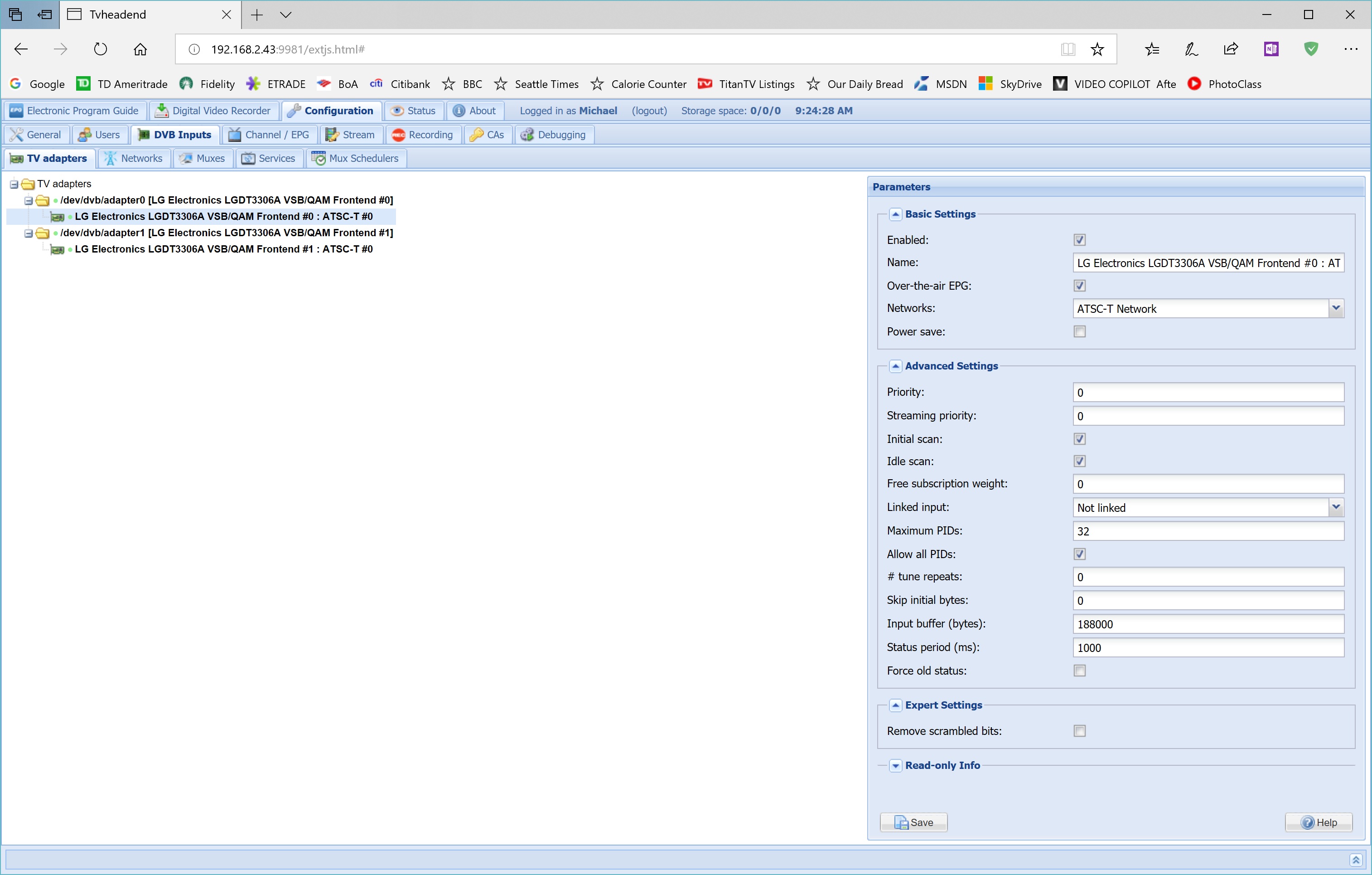

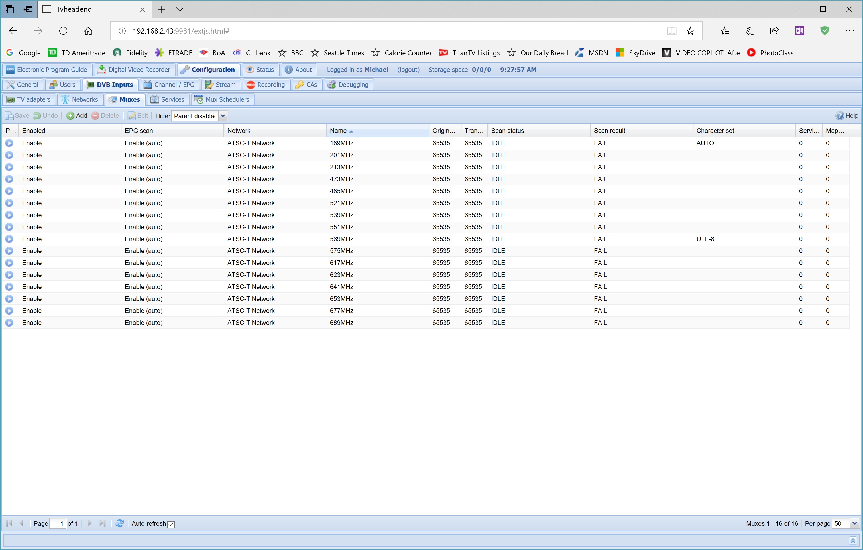

  • I have installed LE on an AMD A10-5500 system with a Hauppauge WinTV 2255. Installed the TVHeadEnd server/back-end and configured via http. The LG frontend is listed in the device list, configured a Network (ATSC-T Network), and use the preconfigured MUXes for the Seattle area (confirmed the freqs were correct). There are no channels or services found and the status is failed.
