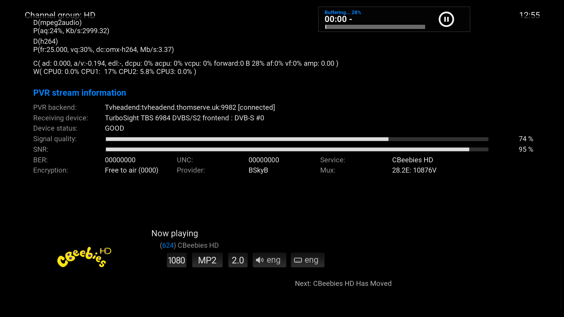

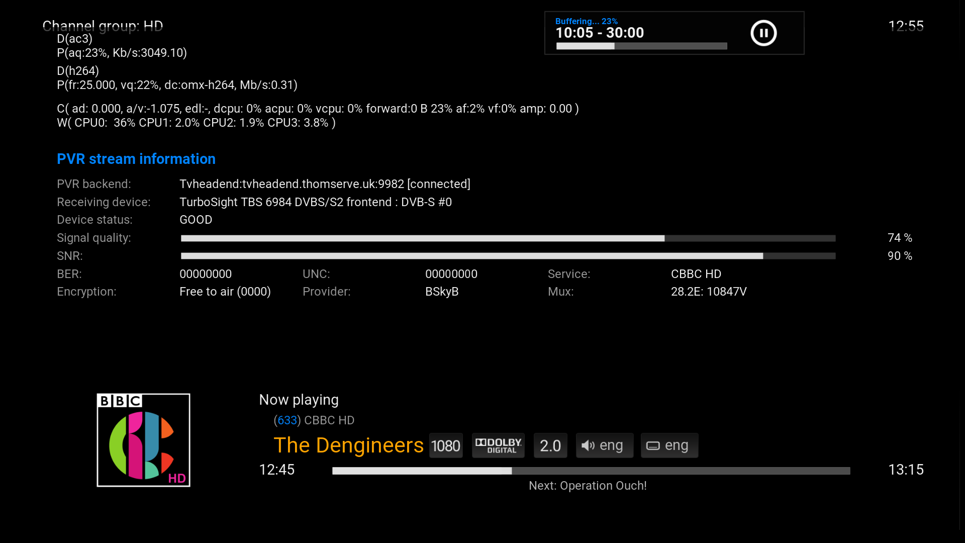

    I've attached screenshots of a "good" HD stream and a "bad" one (both are FTA and both from Astra 28.2).
    Please ignore the 'CBeebies HD has moved' EPG entry - that's coming from the EPG data for the DVB-T variant which I've unmapped now (whilst the Olympics are on the HD variant on DVB-T has been removed/scaled back).
