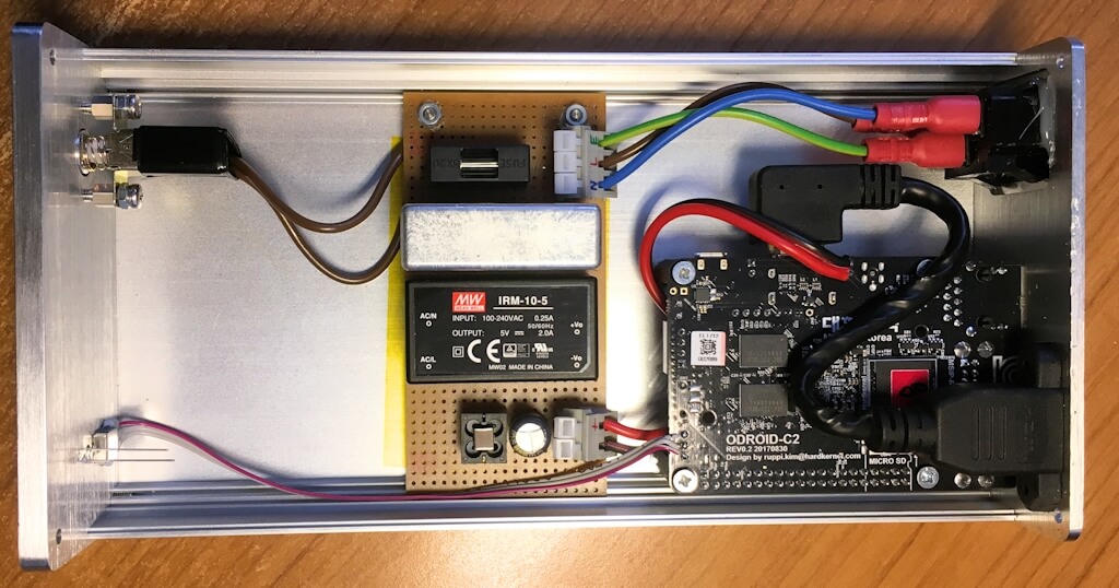

    I have just housed my ODROID-C2 in a Ali box purchased off eBay. The case is used as a heatsink and overclocking the C2 works just fine.

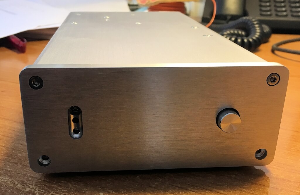

    I would like an LED on the front that shows when Kodi is powered up (ON/OFF via remote) I'm guessing this would be done via the GPIO pins and a line or two of code but not sure where to start, any pointers appreciated.
