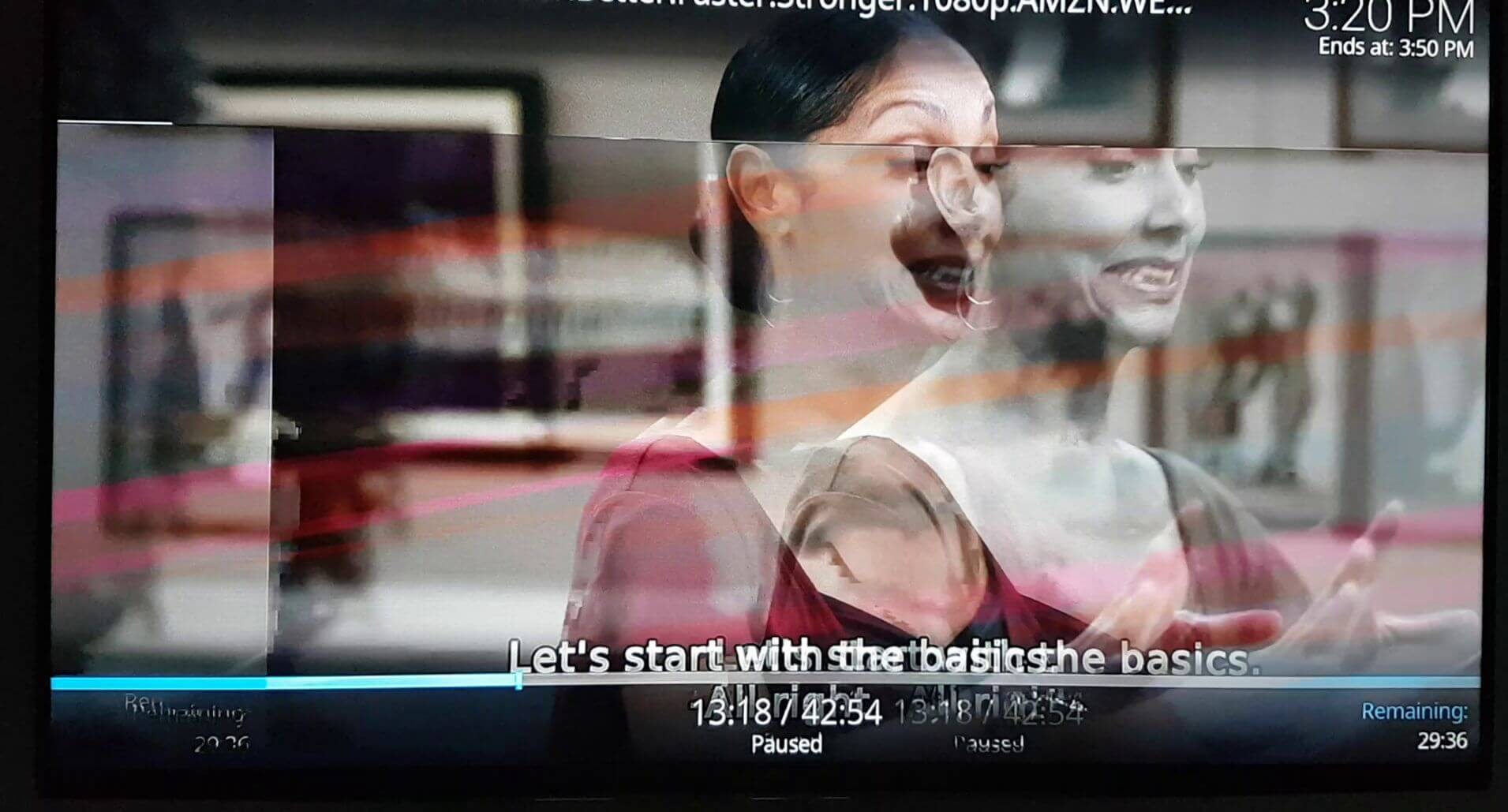

  • I have installed a clean version of Librelec to my PI2.
    There are smaller screen flickers and picture errors but i also have blackscreens for about 0.5s to i guess 3s.
    These problems only seem to occur on 8.2.3. On 7.0.3 which i had previously installed i didnt have these problems.
    I hope you can help me :)
    thanks ,
    cocrea

  • So the problem is
    Not the Power Supply, i switched to external power supply which supply more than enough amps.
    Not the TV i tried a different monitor.
    Not the network playback, i tried playback over USB.
    Not the HDMI cable i tried a different one.
    So either its in the settings or the Pi is broken ?
    Thanks for any help,
    Cocrea
  • Now i have connected my RPI to a different PSU and changed two settings in the video tab and it is working for now.
    I changed:
    Display Refresh Rate : Always
    Sync playback to display: On
    I will report back if i have any further problems :)
