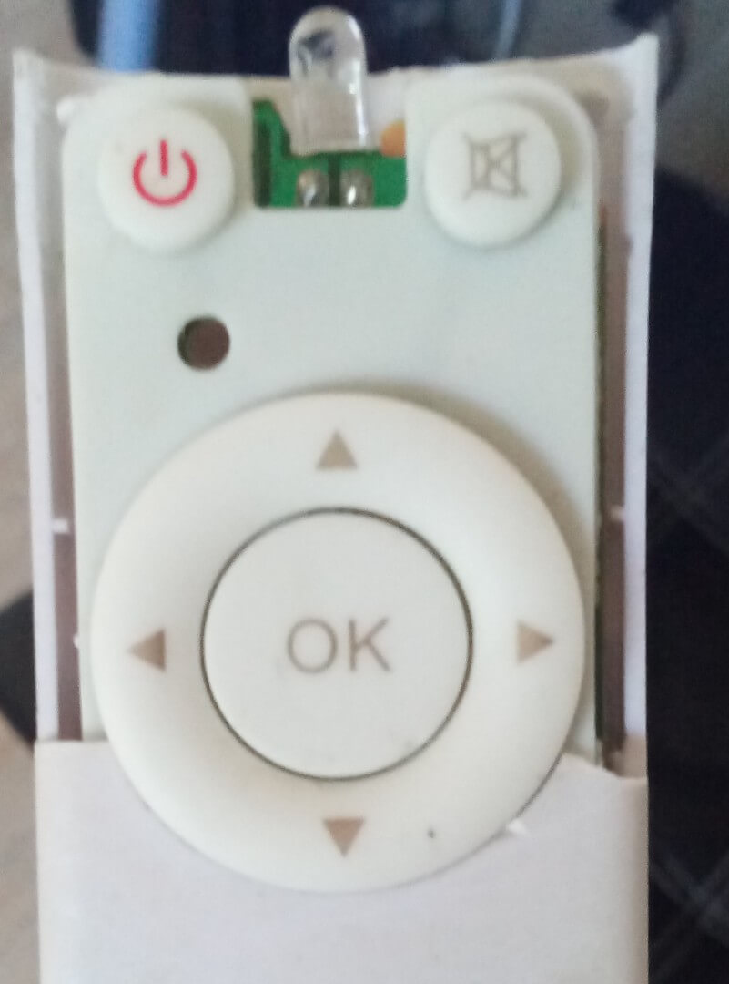

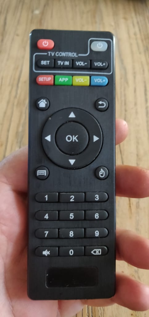

hi all
my original remote control have been eaten by my dog 'and stop working completely
hi have remote control of h96
can i configure this remote to work with tanix t8
thanks shay
