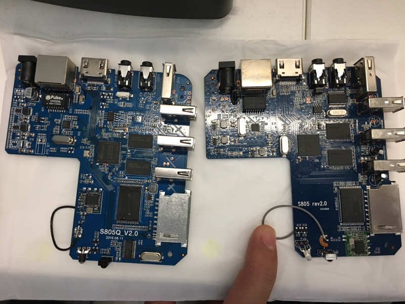

Display MoreHi Kszaq:
I have one of the newer MXQ Boards S805Q_V2.0 that only boots up with your M201D Build and of course it has the crappy 350 Megs. I have tried almost every Build inc. 7.0.3.3C as well as 8.0.0b and I am getting Freezing just with Kodi at idle or even playing Video's. Its random can be 5 mins or 30 mins. I have tried many things. Today I tried one of your first Build supporting M201D (7.0.1.1)and was going to slowly test each version from there moving up.
To my surprise no lockups at this old version. No freezing at idle or playback. Been testing for over a day now. This may be the one i will use.
Question:
I currently have loaded to NAND 8.0.0b and soon I will push from SD (7.0.1.1) to NAND. Will the standard SSh (InstalltoInternal) work for me in this case. Will it overwrite the LibreElec
8.8.8b in NAND ?Thanks for all your great work !!!

I build LibrElec.tv from source code using your fork on github and tried another device tree files than the three available by default to to get 1GB but without success. I tried also to make copy m201d dtd increasing only memory amout to 1GB but it freezes after reboot like MXQ and HD18q images. Is it possible to get 1GB this way?
Maybe I am paranoid but can this board have less memory and the original firmware is mocking the user saying that it has 1GB?

Hi kszaq,
Thanks for the excelent work with LibreELEC for amlogic devices.
I am using this build since version 7.0.3.3a on some MXQ boxes to replace the stock android image with LibreELEC and until now I am very satisfied with the results.
I use the toothpick method and install it to NAND and it works perfectly for all devices until now when I need to buy a MXQ lot from another supplier. With this new lot, when I try to boot the recovery from SD card the recovery process is finished but after reboot it freezes on boot screen and the boot process never ends.
I open the devices and the hardware looks like similar (same processor S805) but in different revisions printed on board (S805 rev2.0 and S805Q_V2.0). The version S805 rev2.0 works and version S805Q_V2.0 not. The attachment of this message contains a picture of the boards.
I need to know if is it possible to make it work with this new revision of board and which information I need to collect to help on the diagnostic of this issue.
Thanks in advance,
Alexandre

Hi kszaq,
It works using image LibreELEC-S805.m201d.arm-7.0.3.3c.zip.
I managed now that this new lot came with less RAM (only 350mb).
The version for m201d works perfectly.
Sorry about the inconvenience and thanks again for the excelent work!
Alexandre
