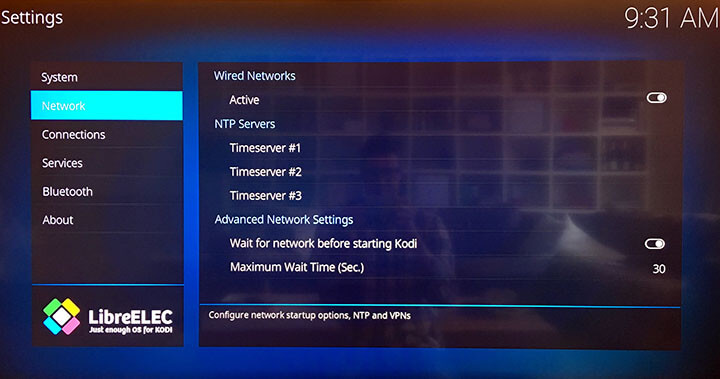

    Going to the LibreElec menu isn't immediately possible (LibreElec settings not ready, try again later).
    After a few minutes, I can go into the settings, and under Network, the Wi-Fi option is gone.
    And even worse- the LAN is also not working. Going to Connections, it shows a LAN connection, but it doesn't work.
    I'm reverting back to the MXIII_Plus build.
