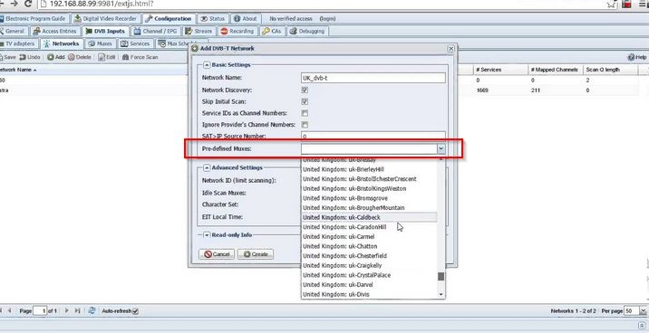

Hi,what do you mean by "auto-default scan" where do I set this up? Which version of tvheadend do you use? I really assume this is some configuration issue...
I checked the thread you linked - nothing newbut thanks anyway!
Pre defined mux should choose " auto-default"

Hi,I am not sure this has been covered before - I am trying to get DVB-T2 working on my K1 plus box. ( I am in Germany/Berlin area if that is important). I am sure to use the correct frequency to search for and while DVB-T works fine and I find all of the available channels, scanning for DVB-T2 always FAILs i.e. I don't find any channels... Running this box using the pre-shipped android works fine and I find all DVB-T2 channels, so it is not a hardware issue...
I would be grateful for any pointers...
groenland
Hi,
Have you tested auto-default scan mode and force scan? This works with Austrian DVB-T2.
There is a conversation about DVB-t2 "beta" german channels.
Howto: Setup german DVB-T2 "beta" channels - Tvheadend

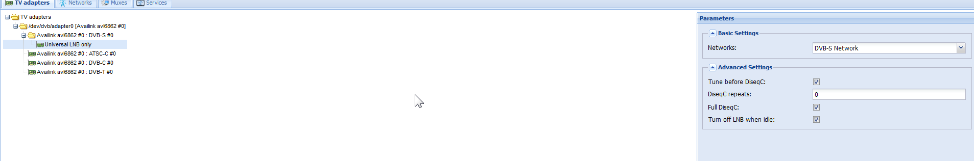

- Configuration->DVB Inputs->LNB->Turn off LNB when idle: checked
- for every standard Maximum PIDs: 26
- Configuration ->Channel/EPG->EPG Grabber Modules->Over-the-Air: EIT: DVB Grabber->Enabled
[hr]It looks like you forgot set "Turn off LNB when idle". Only dvb-s with horizontal transponders had issue.
The problem at "Universal LNB only" was the networks empty and not dvb-s Network.
After that setting works excellent. Many thanks for your job.
