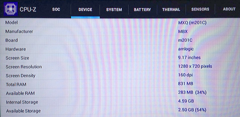

    Device Detail
    MXQ S805 m201c
    Board Model : MXQ-S805_D08 Ver:1.0 DATE:151221
