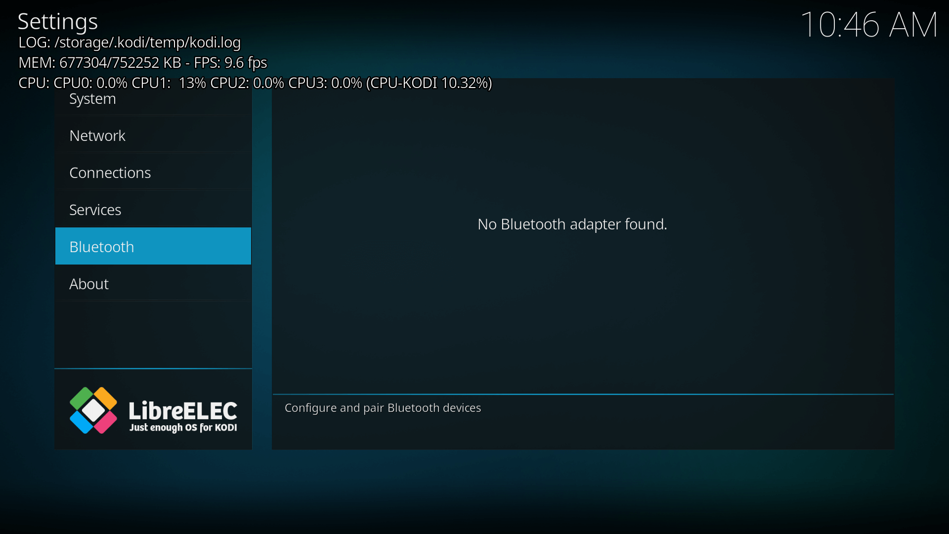

Thanks, i've just done a speed write test on the card and am getting 10mb/s so I don't think that is the problem. I've got a 100mb/s connection and am getting close to these speeds on the rpi so I am at a loss as to what is actually causing this.
Is there a reason that even with the advanced settings my cache is still not filling the ram as it is meant too?
These are my current settings.

They seem to be what Krypton dictates as the new requirements in their wiki yet these are not making any difference whatsoever. It just seems odd that it's only the initial cache causing problems and then the streams works flawlessly for hours on end afterwards.
