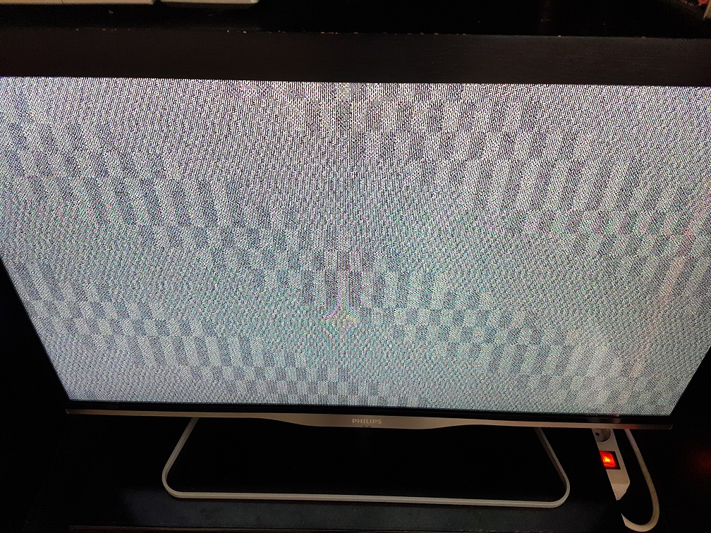

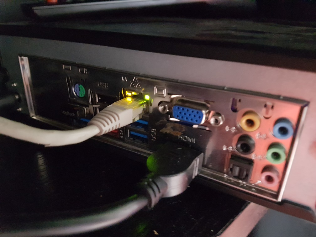

    I tried some more things.
    - tried to load a program partition magic to fully erase my SSD. But partition magic doesn't even boot and gives the same image on my TV.
    - Connected the mediacenter to my LCD. Gave the same bad image.
    - Tried to see if the video-ram (DDR3 shared) was the issue and switched ram modules and banks. Butt all with the same bad image.
    - I tried VGA except the HDMI output, but also the same bad image.
    So it seems that the internal CPU GPU is defect or that Linux doesn't have proper drivers.
    Well back to installing Windows 10 with KODI

    - I have a case where i cannot add a extra graphic card.
    After installation you need to reboot, as soon it goes trough the splash-screen from LibreElec i get a strange video out image (see screenshots) and i cannot do anything.
    Any solution for this?
    I use a generic x86 (64-bit) build beta.
    Motherboard: A75M-ITX firmware 1.60
    Proc: A4-3400
    GPU: Radeon HD6410D
    4GB DDR3

    thing tried so far.
    - Another cable. Didn't work.
    - Bios: Display output: forced to on-board. Didn't work.
    - Bios: Disable HDMI audio. Didn't work.
