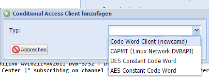

The oscam Server is on my nas and on wetek.. Between my nas and wetek I use cccamuas protocol. And for tvheadend newcamd or dvbapi. This configuration is needed because my nas and wetek are not in the same network and newcamd is not secure over Internet.

I test it with TVHeadend 4.1-2126 (4.1-2126-18.06.2016) and oscam from libreelec repository and WeTek_Play.I can't say of picture freeze, because vnc. But in the TVHeadend Log the same error like before are displayed.
With channels without encryption I have no error.Now I use DVBApi to connect TVHeadend with oscam. Next I will try newcamd.
