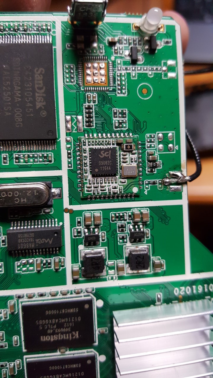

    That's fair. Thank you for all your support and work! I'll definitely be shooting you some coffee money at some point haha. If I happen to see some news on this chipset before you I'll send the link your way. I've also attached a picture of the chipset for you to view if you'd like.

    I've been using the MXQ Pro 4k with the S905X, and my wifi won't work either. It's definitely because of the change in the wifi chipset. I have two of these boxes, the wifi works in one of them and not in the other. So I took them both apart and the working model had a Realtek wifi chipset, while the one that doesn't work has one called Scl (S9082C 11644). I'd upload a picture if I could/knew how to. I've tried finding info about this chipset, but it seems there is no info to be found. With that said, I've only searched google a few times.
    kszaq , do you think you'll be supporting this "new" chipset? Seeing that a lot of the newer S905X models contain this now. If I knew how to write the codes for this stuff I'd offer to help out, but I'm a little far away from that point at the moment haha. I just started a month ago trying to teach myself :P (debatable progress)
