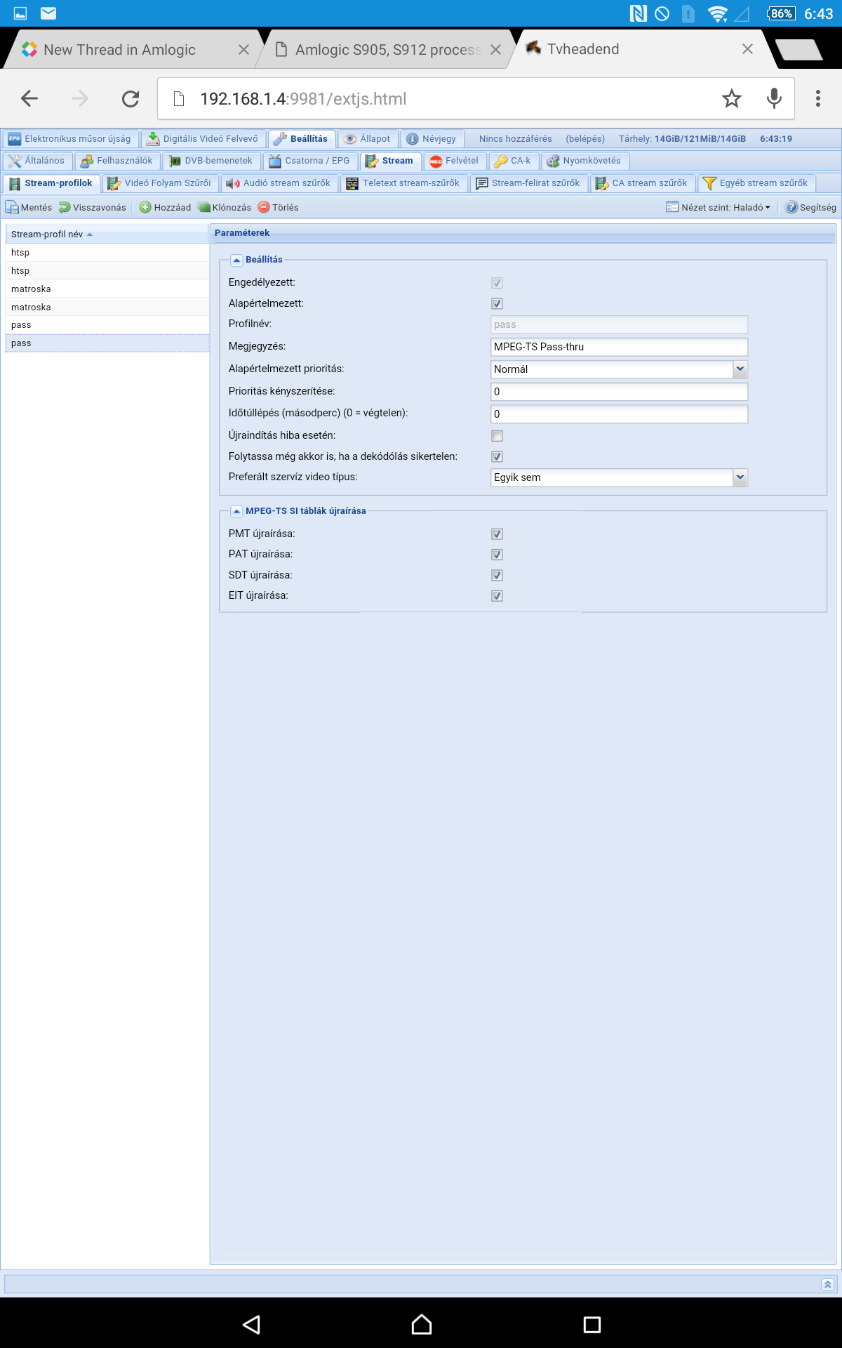

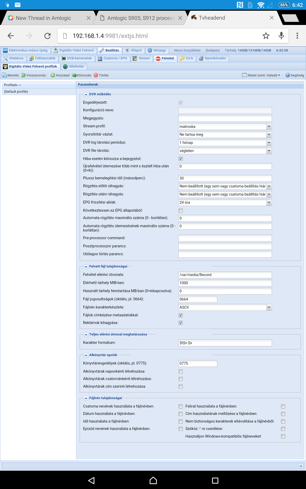

    Live TV streaming profile htsp, and isn't changeable
    Record profile is mkv.
    With htsp profile isn't record the server, and with ts pass profile same result as mkv.
