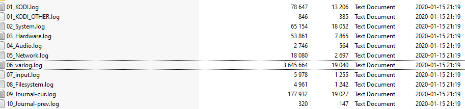

Liquidmercury : you should probably provide the zipped log file, not just the var logs

That's the thing, I can't seem to produce a proper log for the issue as pcsx2.sh doesnt seem to run properly and does not generate any error. Is it possible to uninstall and re-install pcsx2? or open some gui for it to just see that it actually starts?
But I'll upload what I've got and hope there's something there. -
The varlog.txt? Logs for PCSX2 is in /var/log/pcsx2.log, there should definitely be a log showing the specific error.
Just post the logs from the log share as described in post 1.
/var/log/pcsx2.log is empty
This is from the zipfile in logfiles, that's the varlog i meant which i thought you meant as well (at least the zip containing all logs) -

the varlog.txt doesn't give me any info either, so I'm running out of ideas.
