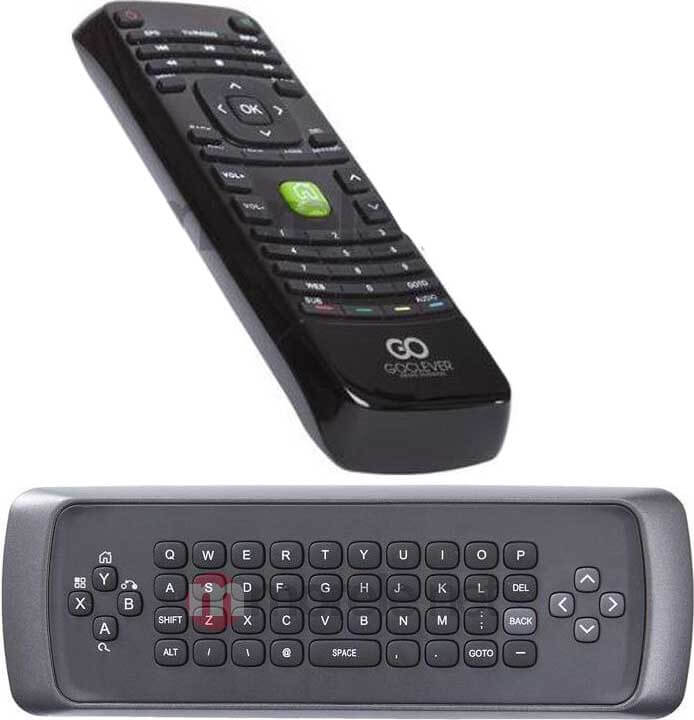

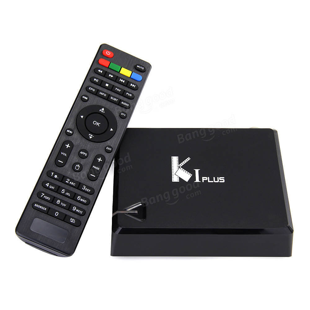

And what is the driver for the default remote control (K1 plus S905 see picture below) to connect to as a second remote control?
One more problem - how to map letters from remote control with keyboard in Lircmap.xml file?
In the file in the rc_keymaps directory I have eg
"0x72ddb0 KEY_Q"
and try to assign it to lirc in Lircmap.xml in various ways
<q>KEY_Q</ q>
<letter_q> .... unfortunately nothing works
How can I map a letters and special characters, e.g., space, comma, dot, at, slash, backslah, colon, etc.?
I made a file to operate the remote from the old box GoClever Android Box (up to version 8.90.4 I had it as a second remote control along with the default one entered in the system).
Unfortunately, the keyboard does not want to work with the letter keys. I wrote in /storage/.config/rc_maps.cfg
following line "meson-ir * my_file" and I entered the command "ir-keytable -a /storage/.config/rc_maps.cfg -s rc0" via ssh. I'm not happy about the pilot's work. When I delete the line that I added in rc_maps_cfg I have no new or old remote control. How can I return to the remote installed by default in the system (K1 plus S2 T2 from China s905).
Thank you in advance for your help in solving the problem
