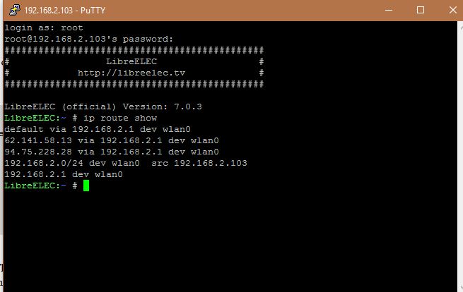

See thumbnail in entry 7, see attachet file in post 9
Nameserver 94.75.228.28, 62.141.58.13 -

Libreelec as well as OSMc failed at the name resolution. The DNS servers work correctly, it is the same server as entered in the router. While the name resolution works on all other clients in the same subnet, there are problems in libreelec and OSMC. A ping on an IP works, a ping on the name "bad address 'google.com'On other clients tracert name or traceroute name works fine.

From my subnet I can not use libreelec in the internet.My configuration is correct, it is not. Standard gateway is my router, the IP is in the same subnet, the subnet mask is correct

No matter if DHC or with fixed IP, whether Wired or wireless, whether libreelec or OSMC I get with the raspberry pi 3 no Internet or no access on the internet loadable add-ons. -
