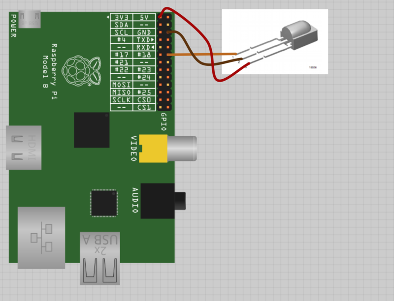

    Hello,
    I already post this to the OE forum (similiar topic about IR, and this topic was hinted for me by HiassofT), but as my platform is LE, I would post it also here:
    I cant make IR work on Rpi2 platform without lirc.
    I have this setup:
    dtoverlay=gpio-ir,gpio_pin=18,gpio_pull=1,rc-map-name=rc-rc6-mce
    When I try ir-keytable -t, no input shown from NEC and Samsung remotes. I also tried all other (-p rc-5, then rc-6, sony, sanyo, nec) explicitly, and test with NEC, Samsung and even Panasonic TV remotes, and still, no info at all. I dont know, where could be a problem here. The TV (Panasonic remote) is quite new, like 2015/2016 model, so I think it should be recognized by something.
    Btw., Samsung remote (which I using with lirc) has this kind of codes inside lirc conf:
    Any help would be appretiated. I think system doesnt operate with IR module at all, but I dont know what to setup differently except pin number.
