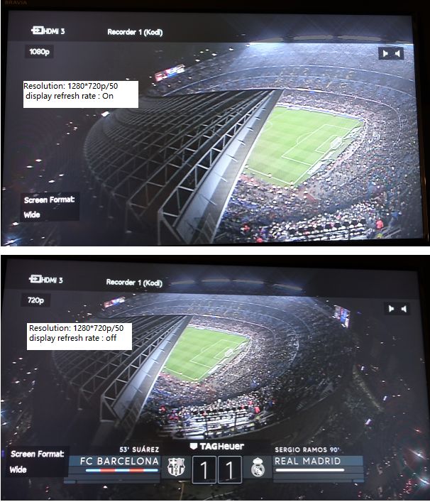

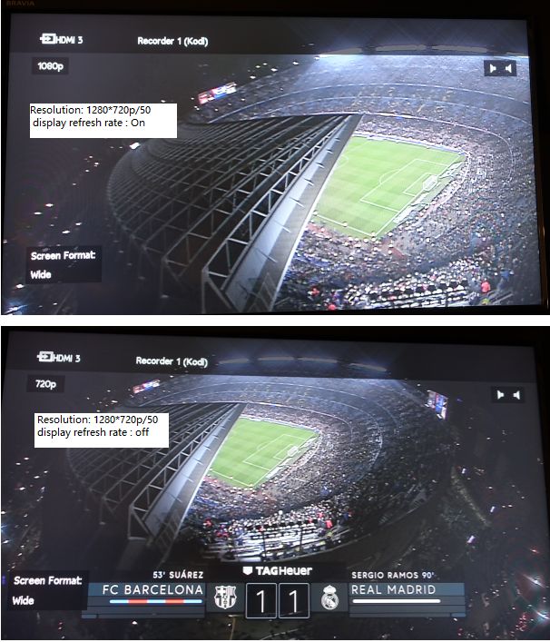

    Please set resolution in Android to 1080p 60Hz or 50Hz and try again. Is it OK now?
    Yes, now it is ok !!! 1080i / 4K is played without any problem. But strange : even with 1280 * 720 now the whole pictrue is there, yesterday it wasn't

    a) Beelink MINI MXIII II is connected to 8 years old Full HD Sony LCD. Adjust display refresh rate is enable by default and I have problems with 1080i/1080p/4K material. My Tv doesn't show the whole picture if Adjust display refresh rate is enable, see attachment. Is this normal ?
